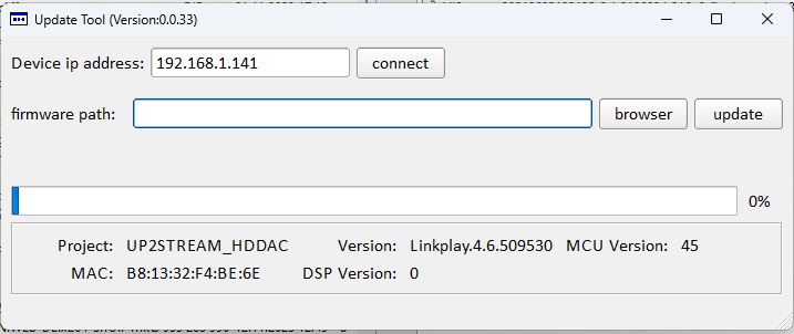

Hello everyone,
I’m experiencing an issue with my Arylic Upstream HD DAC, SPDIF In Board, OLED Display Module, and Case of Up2stream Series device where the sound disappears for 1 second. My device is running firmware version 4.6.509530.45 with a build date of 20230302.
I’ve attempted to reach out through the support chat and via email, but unfortunately, I haven’t received a helpful response. Even after referencing information from this forum about the existence of new firmware versions, I was informed that there are no new firmware updates available to address this issue.
Following the instructions provided at Firmware |, I set the Update Server to http://ota.rakoit.com/alpha and received an ‘OK’ response, but no new updates were found.
Additionally, attempting to load the firmware file (a97_rakoit_new_SECURE_uImage_ota_moduleMulti_20230918_4.6.zip) posted above through the Update Tool didn’t resolve the issue. After uploading, the device simply restarted and continued to run on the old firmware.
I’m seeking assistance and would greatly appreciate it if someone could provide me with a firmware update that fixes this issue for my device.
