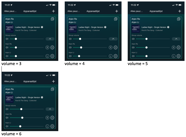

Picture: example of mismatch in volume control.

When changing volume, the volume does NOT change equally on both channels (L + R).
Case 1: volume UP testing– Starting with the volume set to 0, the volume is increased in single volume steps, by pushing the volume up button on the iPhone. The following screenshot sequence shows what happens with each step. If you look closely, you can see that the volume on left and right channel move uneven.
What happens with volume UP
  • 1st test – From 0 to 1; only the right speaker responds, the left speaker stays at 0 / off. When increasing the volume from 1 to 2; the right speaker goes up one level, the left speaker jumps from 0 to 2. It seems that at every uneven volume up step, only one channel responds. And at every even volume up step, one channel moves 1 step and the other moves 2 steps.
  • 2nd test – Doing exactly the same (moving up the volume step-by-step), I noticed following. From 0 to 1 only one speaker goes on (like before). After moving to level 2, the other speaker also switches on, but the volume difference remains 1 step between the two speakers. Even after increasing the volume 7 steps.
  • 3rd test – Doing exactly the same again, so starting at volume 0. The 4Stream App does not respond at all to increasing of the volume by pushing the iPhone volume buttons.
  • 4th test - When using the 4Stream App for volume control, and increasing volume by using the ‘Group volume’ slider, left & right speaker move equal and in the right steps.
Case 2: volume DOWN testing– Starting with the volume set to 6, the volume is decreased in single volume steps, by pushing the volume down button on the iPhone. The following screenshots sequence shows what happens with each step.
What happens with volume DOWN
  • 1st test – From 6 to 0; at the starting point, the volume levels at left and right speaker are even. From the first step for volume down onwards, one speaker stays a level behind. This goes one coming to level 0. But the speaker that was one level behind is unable to reach level 0. So, the volume stays on with one speaker. It is not possible to get it to 0 / off.
  • 2nd test – More or less the same happens, but sometimes the difference between the left and right speaker, is 2 levels.
  • 3rd test - When using the 4Stream App for volume control, and decreasing volume by using the ‘Group volume’ slider, left & right speaker move equal and in the right steps.
