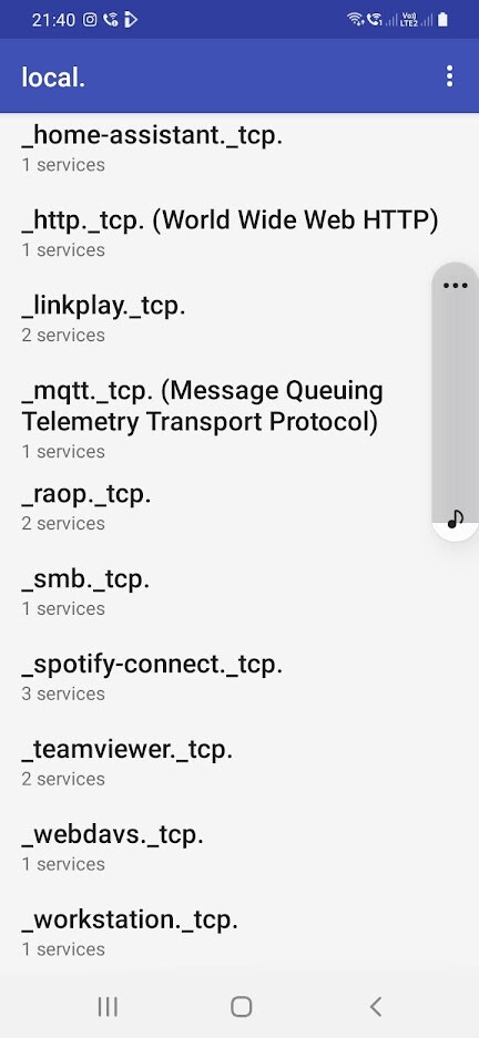

If not check this on your android phone Spotify Discover use https://play.google.com/store/apps/details?id=com.druk.servicebrowser&hl=en_GB&gl=US
You should get something like this
Then This
Forget YouTube Music for now. Let’s get Spotify up and running
We are looking for a healthy Spotify Connect Service on 192.168.1.10 (Your S10)
Regards, Kevin

Your laptop needs to “discover” the Spotify Service on your LAN.
The APP we used on the android checks that the service is discoverable. The result is you have 2 devices running the Spotify Connect Service. 192.168.1.10 (S10) 192.168.1.8 (TV ?)

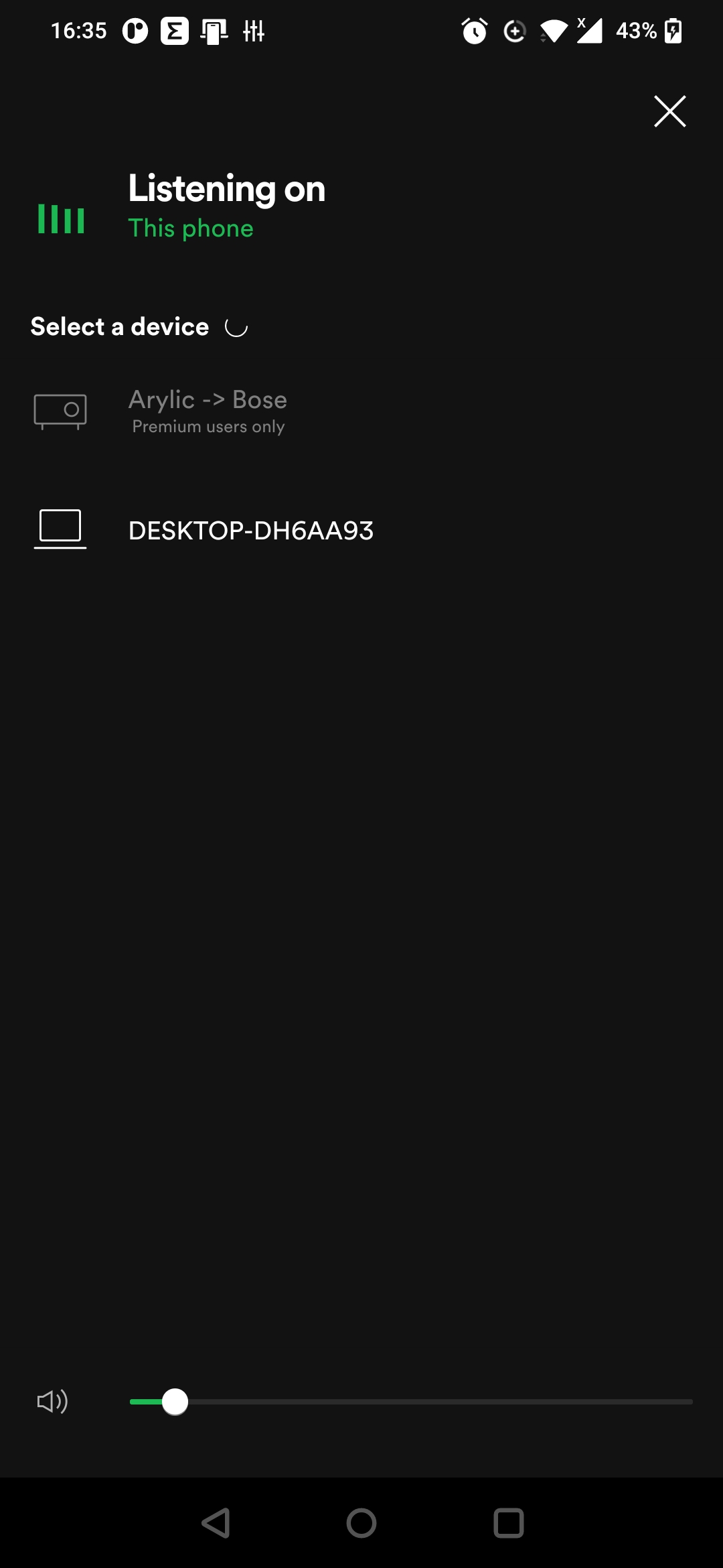

Hi Kevin,
I think I need to subscribe the premium service of spotify.
When I execute the spotify on my android and try to connect to my laptop I have this screenshor:
Then the spotify on my laptop don’t have the Arylic enabled because I didn’t connect the spofity on the android to the laptop:
Do you have the Premium?
But has I said, to subscribe, I prefer the YouTube Music if it is possible to stream with it to the Arylic via the Laptop.
Thanks
Yes I do have Premium but I also had it working with Free. However this can also be Country dependent too
