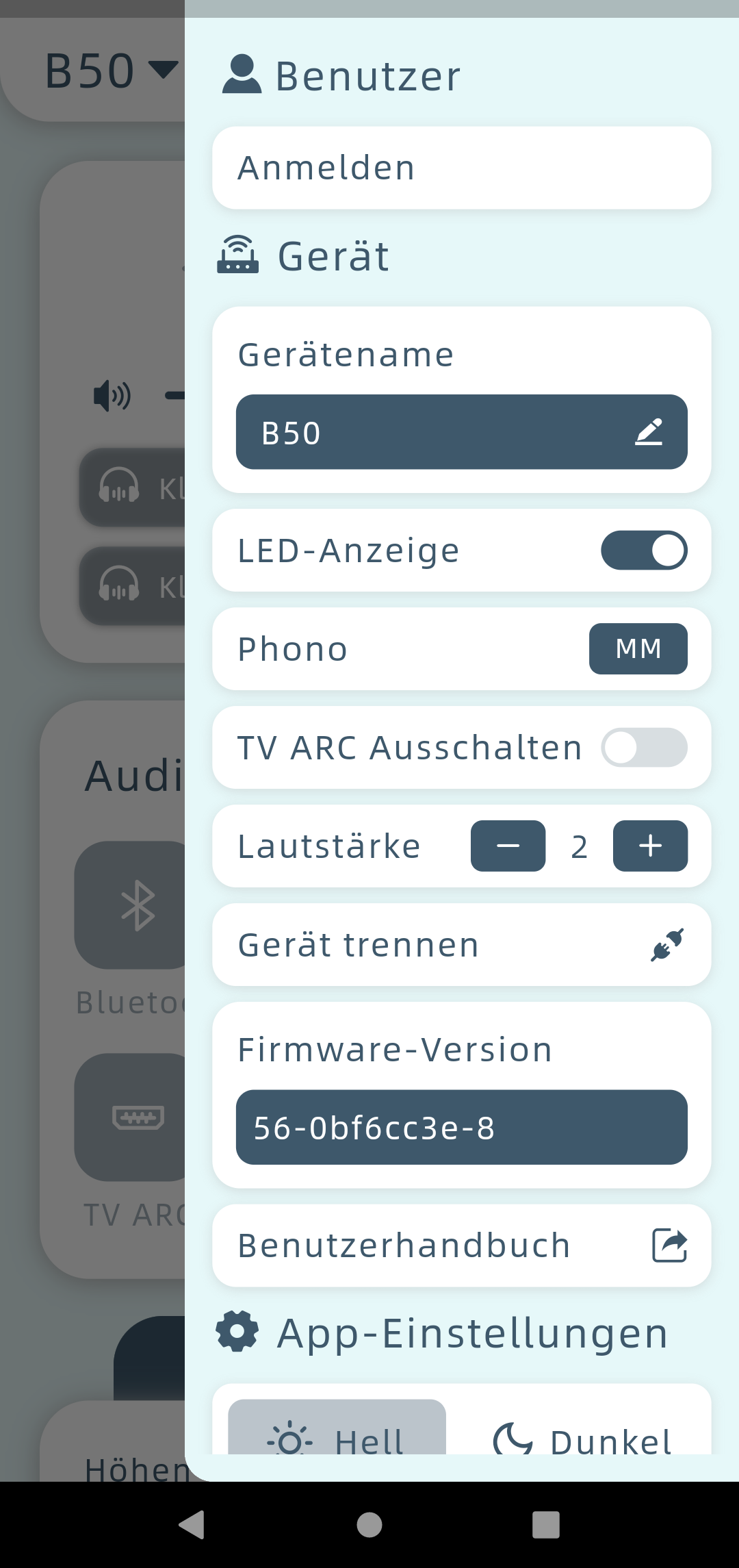

WTH. I connected the device with ARC to my PC and now I’m able to use the B50! Seems this fixed it. :astonished:Firmware is on 56-0bf6cc3e-8 now.
If I switch off the device completely I have the same problem again. After putting in the ARC cable the problem has gone.
