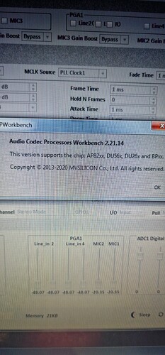

I was finding out that i have 2 versions of ACPWorkbench on my Laptop.
The 2.33.0 version and the 2.21.14 version.
Just because i was curious i checked if the older version worked.
And it worked flawless.
I can now turn of my Arylic 2.1 Plate Amp or deconnect it from power, turn it on again and the Amp plays how i created it.
So not going back to Factory settings.

ACPWorkbench 2.21.14 download? Where can I download ACPWorkbench 2.21.14? Maybe share the program here or give a link. I’m from Belarus, and I can’t find this version anywhere.
