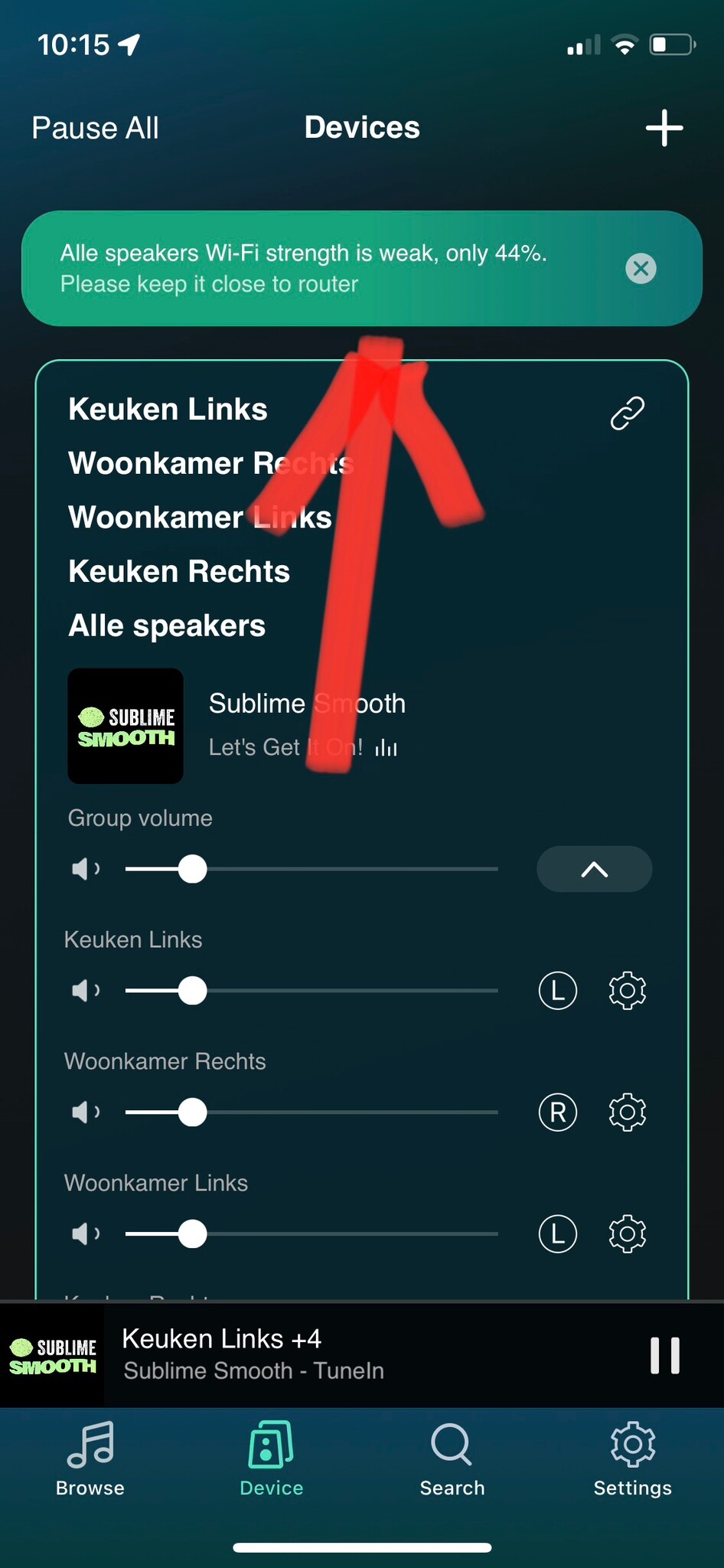

I have done a test, to compare the 4Stream App to the WiiM App. I unplugged my WiFi Extender to decrease WiFi signal strength. Here’s what happened:
WiiM App = left image / 4Stream App = right image
So they both show the same notifications.
In fact, this is not a surprise. Both Apps are based on the same software. Just some differences in looks and functionalities.
So in this (test) case, it made sense that the App shows a decrease in Wi-Fi strength.
But the case for which I started this thread is a different one. Because there nothing changed, only the update of the 4Stream App. So I am still wondering if there is a glitch in de software App.

The WIFI signal strength is read from device, on old APP, user have to open the information page to read it. And the new APP would notice user when found signal is weak. I think this is an improvement and not an issue actually.

I also don’t know the threshold of the weak signal, as you know, the APP is inherited from Linkplay, we don’t have the souce code, and also has no willing to know such details…
And the issue might be interference of WIFI channels, the device should find a suitable channel itself after some time. But when some other devices (like phone or pad etc) come in and out, it might affect the connection and cause signal weak.

My evolved understandig is that the 4Stream App just looks at the measured WiFi signal strength, compares it to a certain treshold, and when below that treshold it shows a notification box.
So for me, it is no longer a bug or potential bug. It is a flaw / sudden change of WiFi coverage in one area of my setup.
