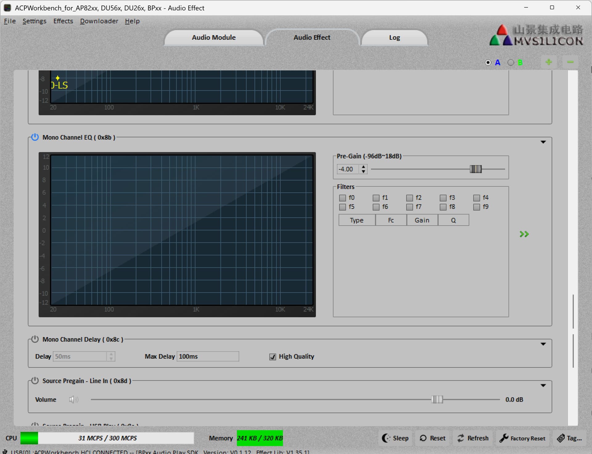

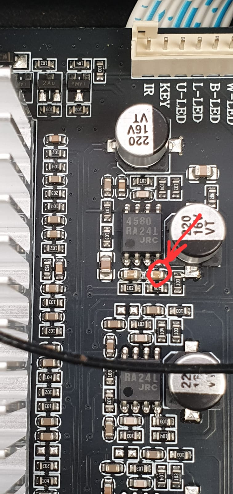

I also paid for ACPWorkbench license hoped that the Plate uses only firmware lowpass filter. Removing the mono channel filter in ACPWorkbench didn’t help. The board still has hardware lowpass filter.

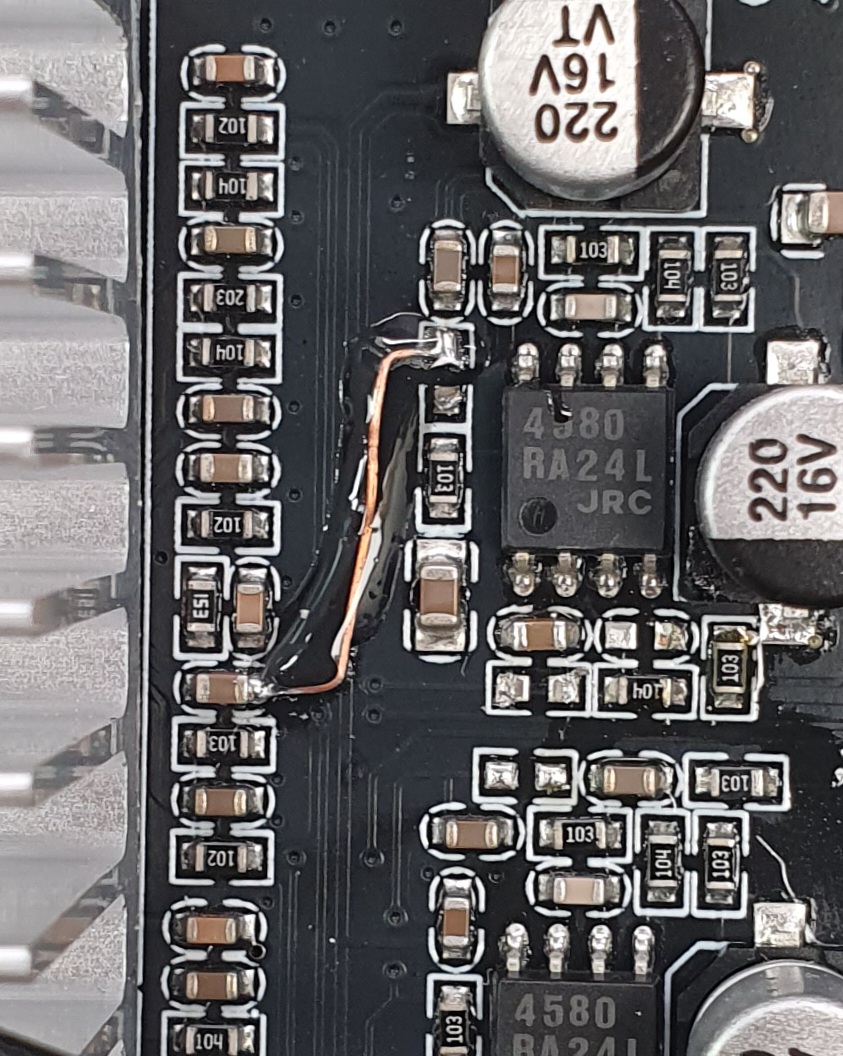

I did some extra research and removed the 44nf capacitor on the board and this slightly improved the situation but highest frequencies are still filtered out somewhere. I need support or suggestion what to try next?

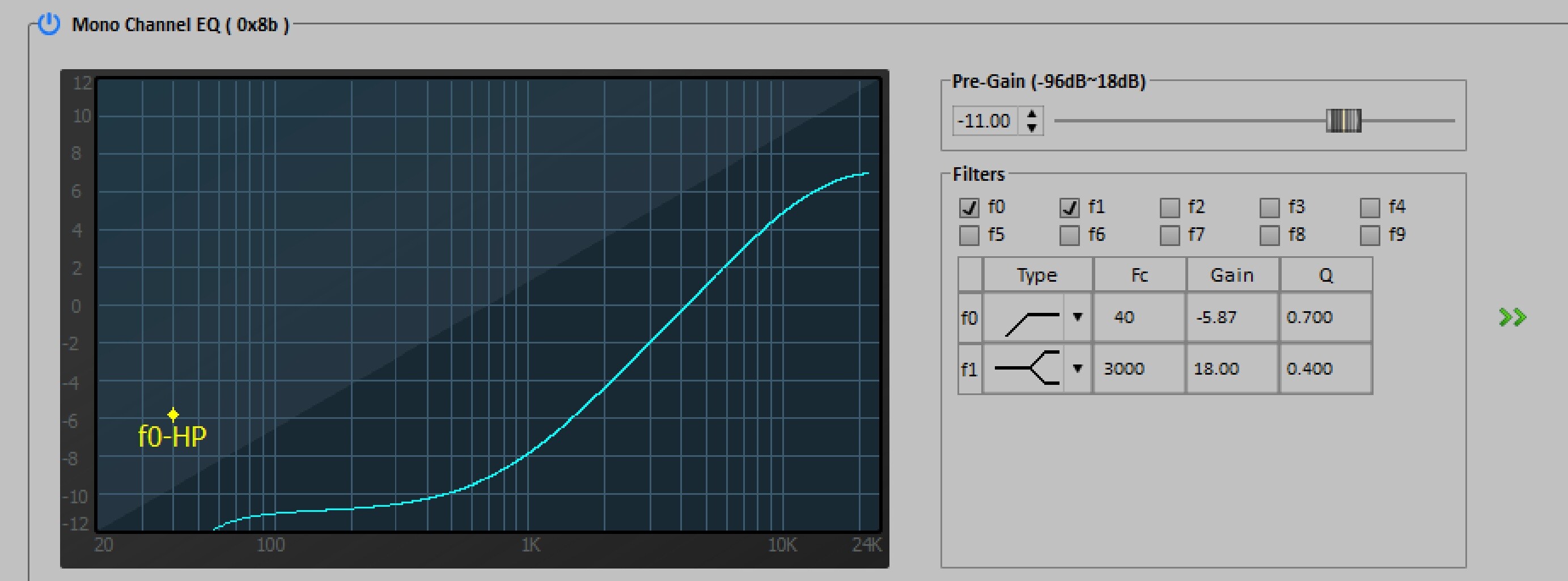

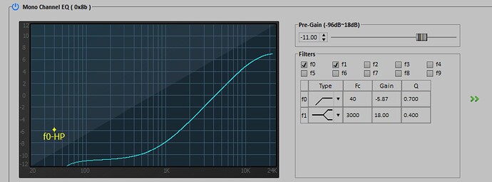

So far I added the highest frequencies boost in ACPWB. Now it sounds almost like perfect but I hate fixes like this. I’d better remove one more capacitor somewhere so I will continue the research

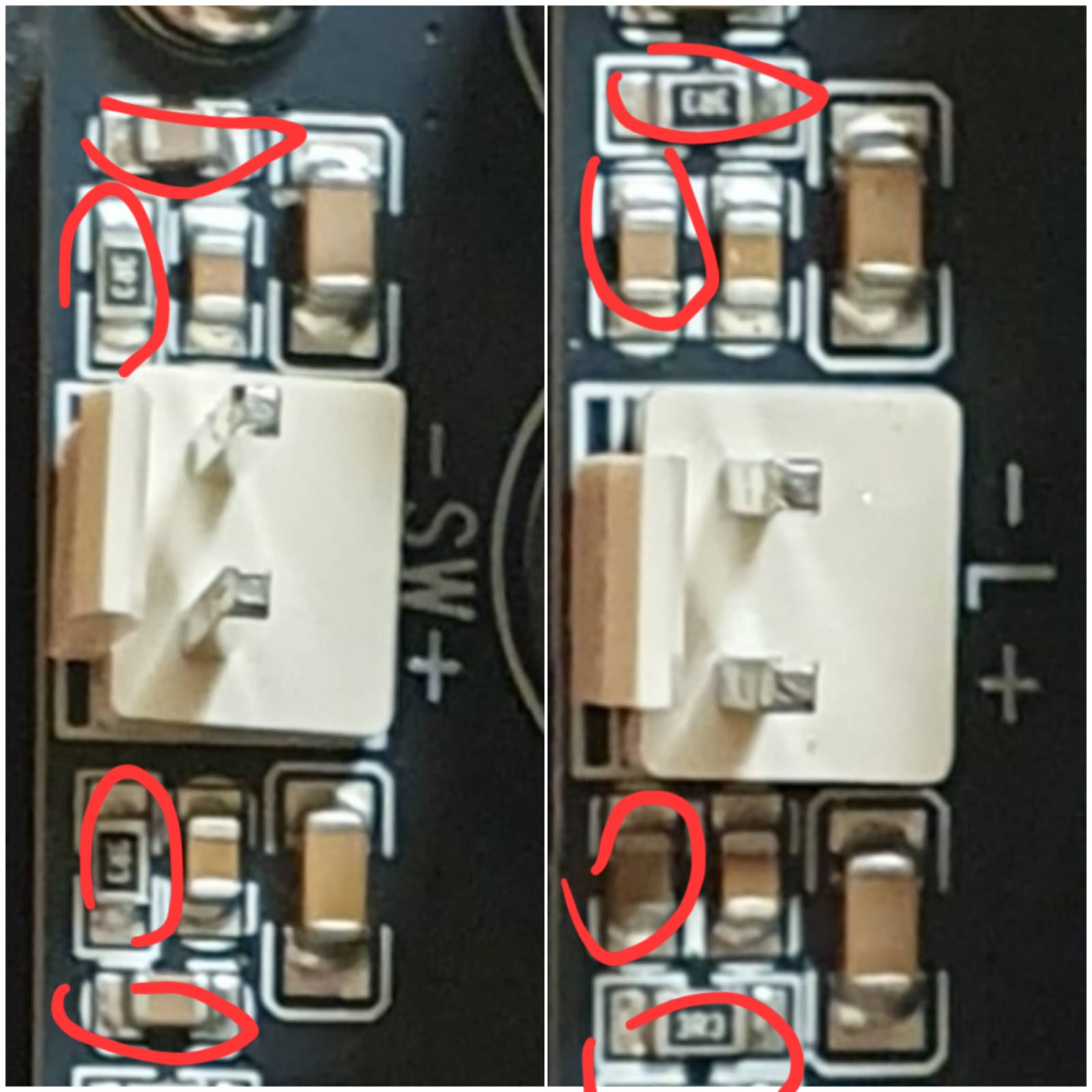

Meanwhile I took a look at the channels output filters and there is a clear difference between “normal” L/R channels (the right side) and the subwoofer one (on the left):
I guess the solution is here?

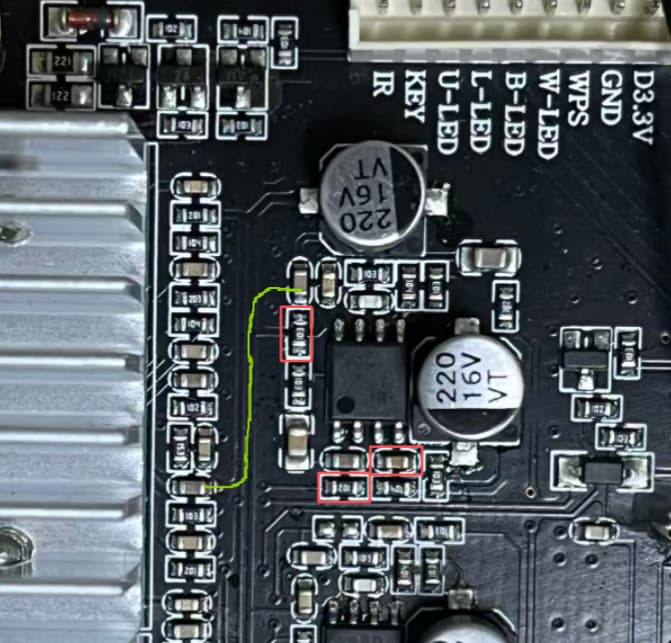

please remove the 3 components marked with red square, and connect the 2 points marked with green line.
That worked perfectly, thank you very much!
