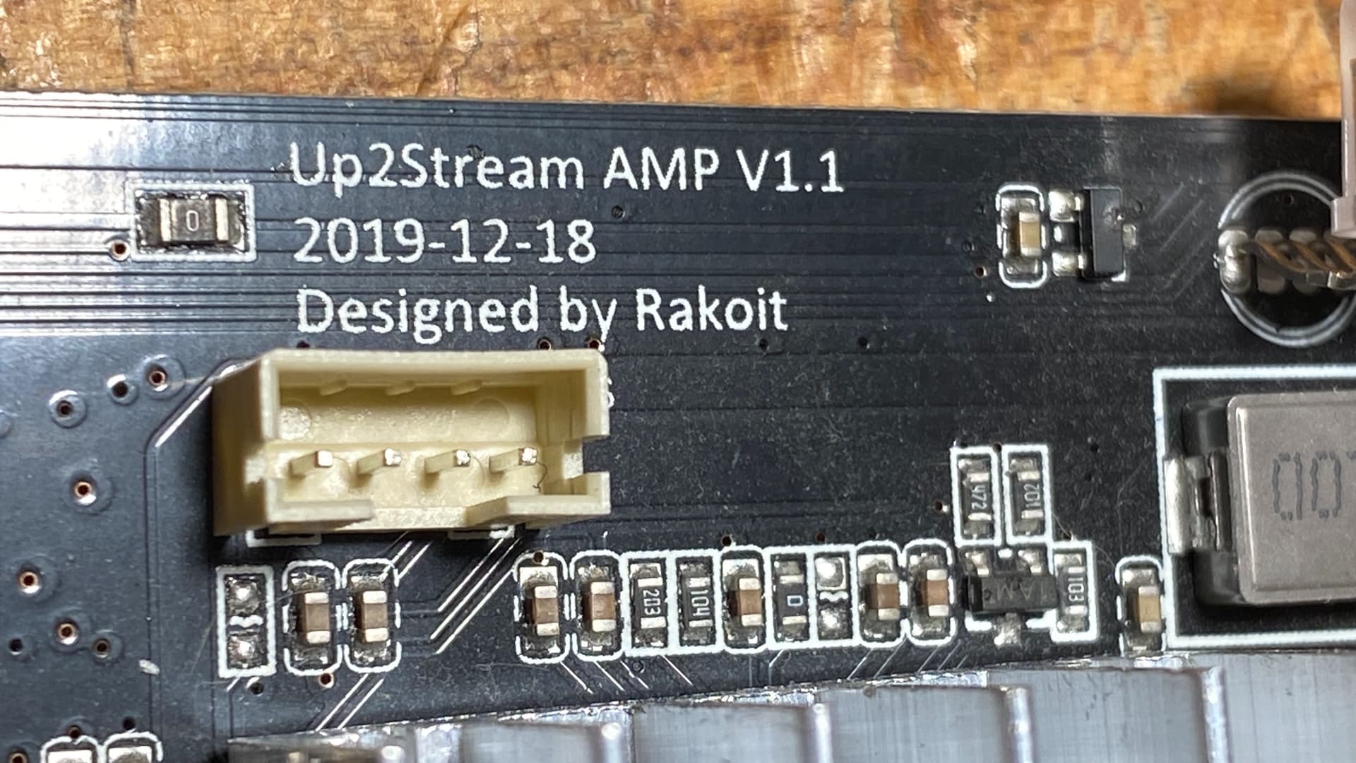

Hello all, I have an up2stream board that went belly up, the stamp on the board has up2stream AMP V1.1
and it was running firmware 4.6.415145.24 build date 20220427

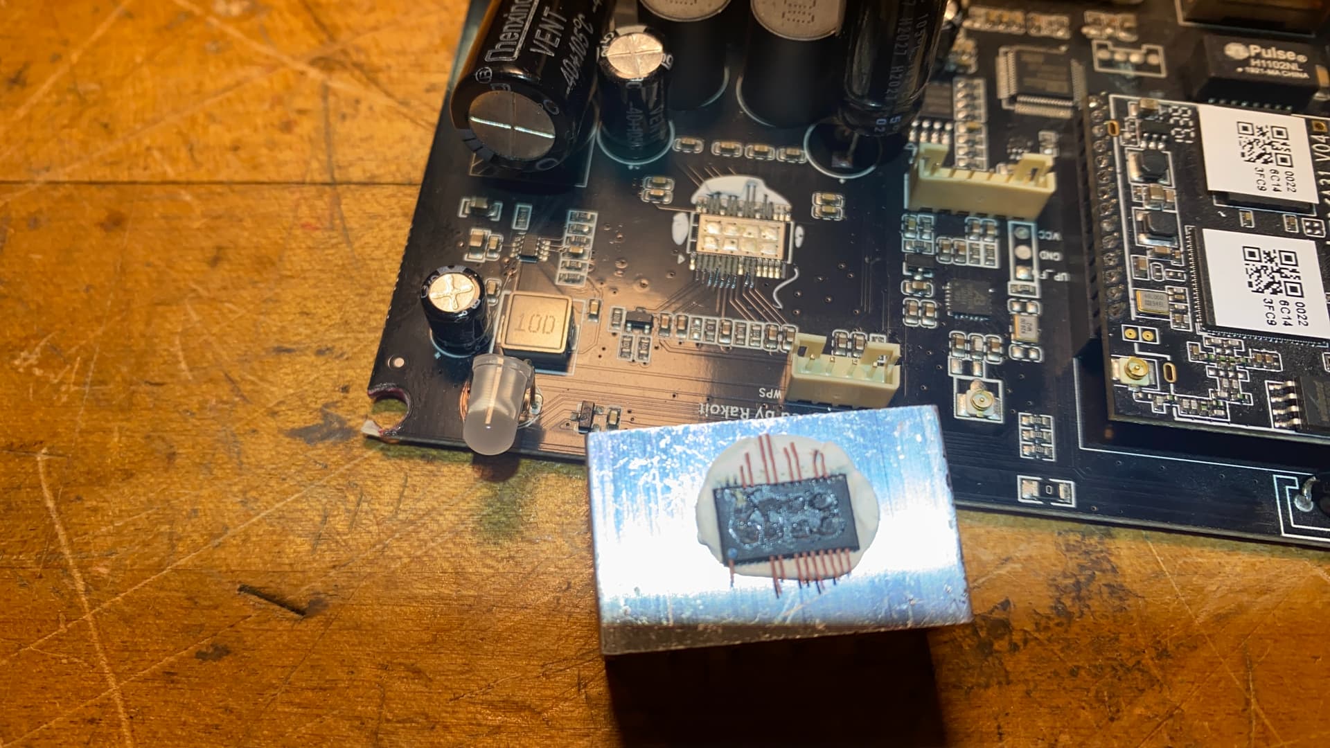

OOPS, I broke it, :unamused: while trying to get the heat sink off I applied too much force and ripped the chip right off the board so this one is toast. at any rate, its amazing how much power this little chip can deliver and still sound decent. In retrospect I should have tried to heat the chip with a heat gun and pull it off that way rather than trying to get the heat sink off. I tore all the traces on the board and its not worth trying to fix at this point. don’t try removing the heat sink. its stuck on really well.
