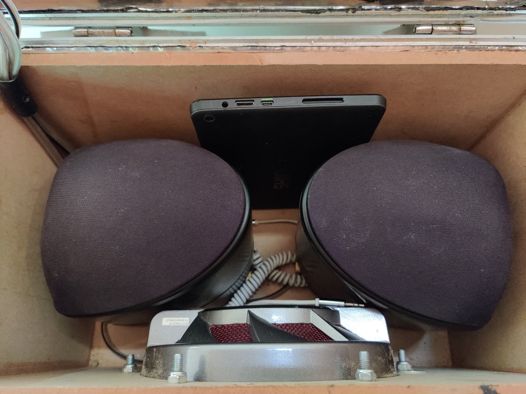

Inside the Mirage Speakers and control tablet safely stowed.
I enjoy Mirage Speakers and the omnipolar sound they create (not for everyone, but I like it). I had rescued a pair of Omnisat v2 satellites from a garage sale, cosmetically mistreated but intact. Beautiful speakers with stunning power for about a pint in size, you can see where this is heading.
Their main limitation is base reach which trails off at 60-70hz. Well that won’t do, not for a sound quality focused system. Considering cabinet size of the flight case, the wish to transport the mirages inside for safety and the need for a subwoofer to fill the low end, a low profile pioneer car subwoofer was ideal for a sealed cabinet size.

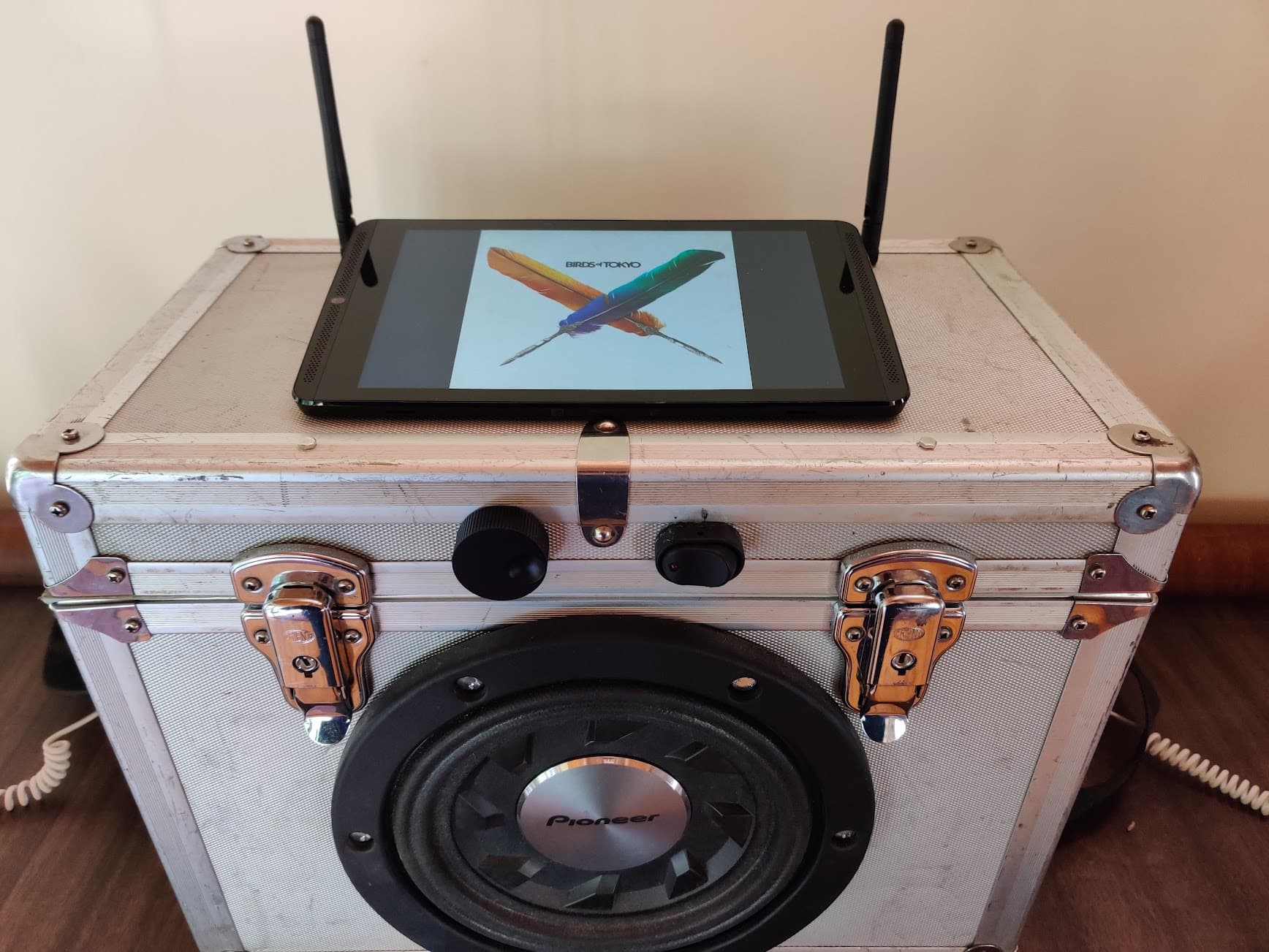

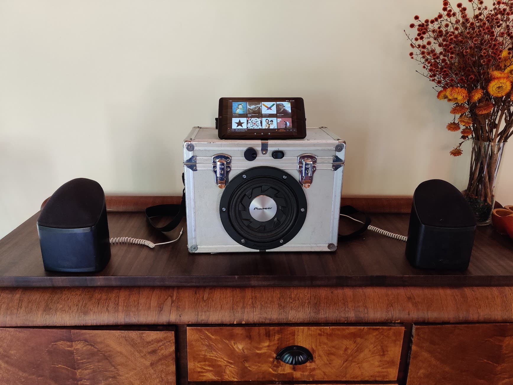

And the unit setup and ready, I can place the Mirages out up to a meter each side for good stereo placement

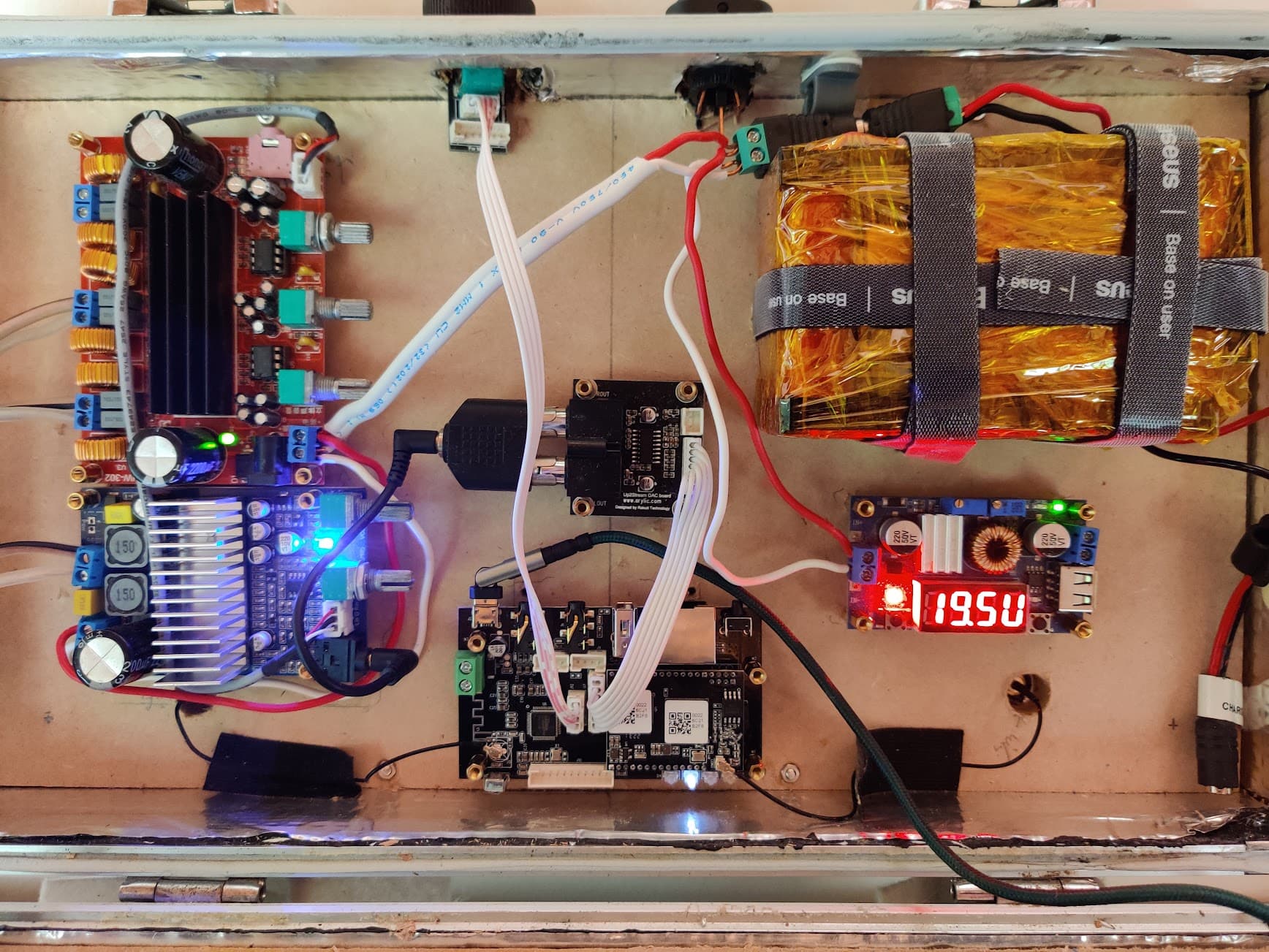

During testing of the first (of many) iterations of the build I skilfully put 12volts and a truck load of amps through the Up2Stream Mini V1 I’d already had for a while. Seriously not recommended, and due to my stupidity, I did in fact let the magic blue smoke out and killed it. Not to worry, there had been a couple of updates and finally this build with a up2stream pro v3. In addition I’ve added the volume knob and improved DAC sub board and the aerial kit for external Wifi and Bluetooth (aluminium flight cases makes a surprisingly good faraday cage and measuring wifi range in inches ain’t good).
The system is mounted inside the lid of the Flight Case. Up2Strem Pro v3 lower centre, Dac Board above, voltage regulator to right with Li Ion Battery pack above, Amps to the left. and volume control board top centre
The Pro v3 drives two amps, both TPA 3116 based. The implementation of the boards makes a huge difference I’ve tried some awful 3116 boards - I’d suggest Aiyiam for sound quality they seem to do well with their implementations and i have had good results. I prefer the sound of the TPA 3255 amps but the risk at a party of someone getting keen and the speakers being overdriven isn’t worth it. I started with the red 2.1 amp (one of the better TPA3116 at the time) but now just use that for the stereo pair only ~50w a channel. The addition of the Aiyiam sub amp (100w) with a notably better and variable low pass filter brought the sub to life. I have been pleasantly surprised with the sub in the end. An important note – flight cases are nowhere near robust enough. The walls are very thin aluminium sheet and approx. 2mm ply. As you can see from this photo after much mucking about the solution for me was to line the existing walls with dynomat and then use a custom built 9mm MDF box to line the inside. With careful build and using a very slight taper, the box was friction fitted then the side walls driven in, slightly compressing the dynomat and making a very ridged enclosure. That combined with sorbothane D seals around the lid when compressed by the lid latches forms an air tight enclosure, that with the amp change, made all the difference. (I used the left over sorbothane seal around the base of the case to isolate the system from whatever its on ( stops is walking at high output and objects on the table buzzing).

Powered by a 21v lithium ion battery pack. (Mine is home built, but seriously not an area to experiment with, know what your doing, get it wrong and you’ll burn your house down – just buy a commercial pack, safer and much less grief). The next thing I learnt is that switch mode step down regulators suck. Taking the 21v to 5v to feed the up2stream has been a real source of noise. After a handful of different regulators and a range of filters, the no longer available, ifi usb filter was the best of the lot but expensive and not quite 100%. I’m now using a well regulated powerbank (not shown) which is silent. It’s a pain having another item to charge but unless someone can recommend a silent step down converter it’s in the end best answer I’ve found. The system runs at party level for 6hrs+ (haven’t yet quite got to the point of fully draining the battery)
The tablet is an old Nvidia shield, with a 256gb micro SD full of FLAC files, enough for my entire collection ~ 4,000 tracks. I typically use HiFi Cast to control the Up2Stream Pro v3 via DLNA. Arylic’s app is good and offers more control, but for random people at parties HiFi Cast seems more intuitive, they see the album art of something they know and we are good to go. I typically use my home server on the deck or backyard but can stream from the SD card in the tablet when out and about.
So how does it sound? Remember there has been about 4 years of iterations to get here, but wow. The Mirage V2s (these are much bigger than the much more common nanosat prestige) are really something. Fed clean power, FLAC files into the Up2Stream with the improved DAC board, good amps and you actually get that tingling down your spine you got the first time you tried high end headphones. From near field listening, through to party level, the sound quality is noticeable. I’ve had mates double take and come over to check out the system at parties from the sound alone. I hear detail and position like good headphones. My main system runs Mirage OMD-5s and the V2s rival them (but not the same low end).
Are there better systems? Certainly, but I wouldn’t be taking a $5k DAC outside or let acquaintances play with it at a party. That said its certainly in a different league to any Bluetooth speaker or portable stereo I’ve heard. Oh and there’s that isn’t there. It’s portable for sure, I’ve added the shoulder strap as the V2s are very dense and weight more than they look like they should (5kg for the pair). The pioneer Sub is compact but again reasonably heavy and the addition of the MDF inner shell for rigidity, battery pack etc the system is ~12kg more than I’d originally planned. Fine to throw in the car for a mate’s party, take out on a picnic etc but wouldn’t be carrying it in a 5km trail for camping etc.
