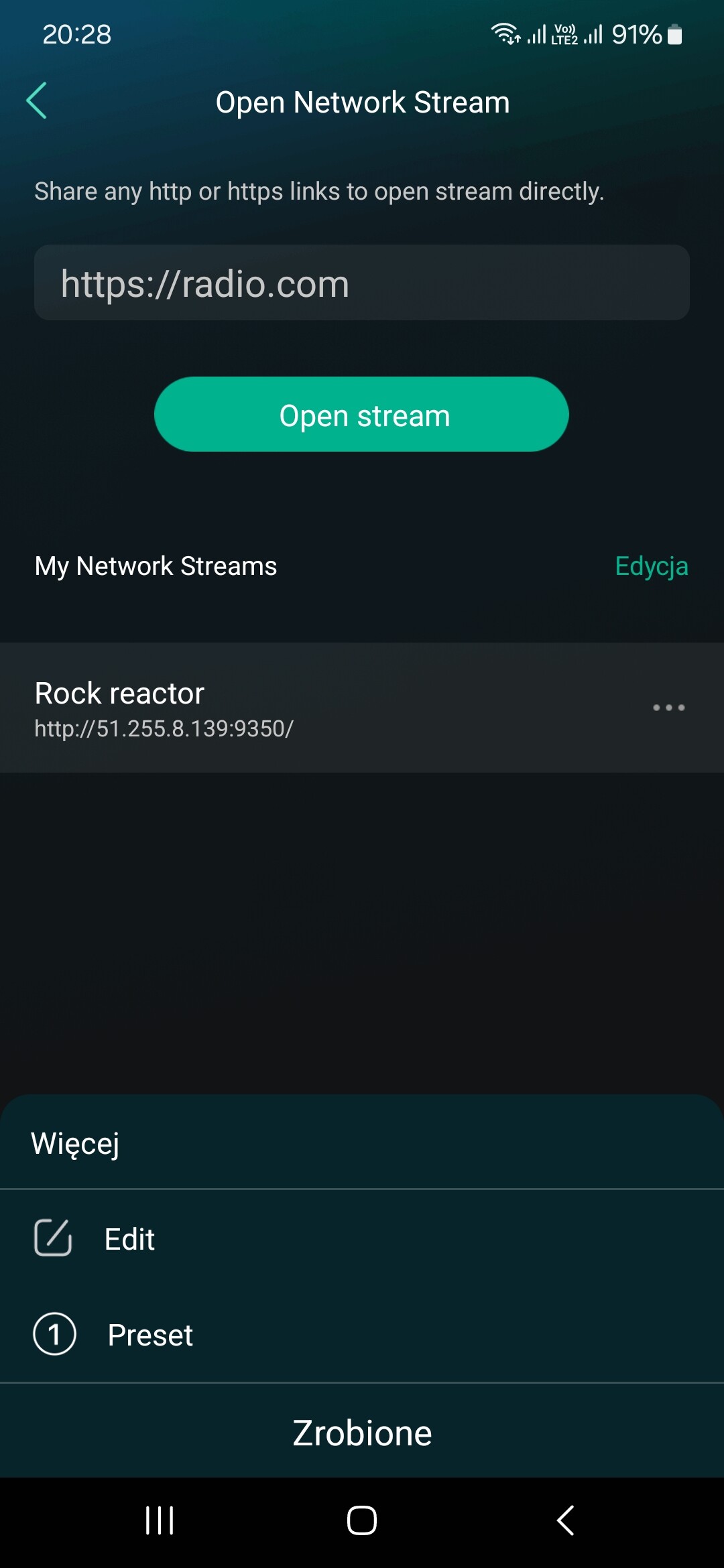

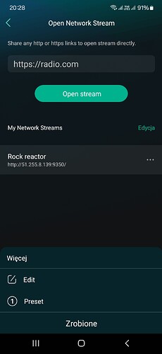

Just checked again today with newly installed app (3.1.20.230912) from Google play shop.
To my surprise: now it works as expected:
  1. I can add new stream manually in Open Network Stream.
  2. A preset option appears at the bottom, allowing to save as preset
    3.I can just press one button and it plays my stream.
    Thank you!
