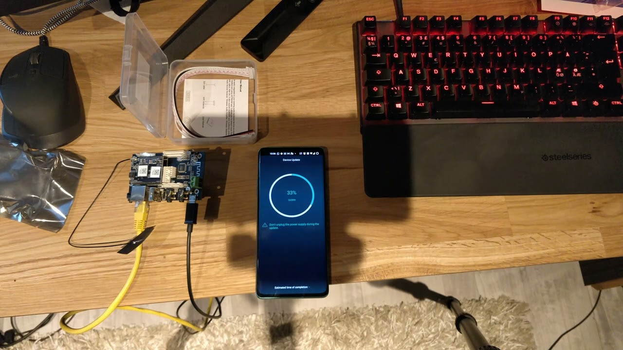

I think there’s still some confusion about what the problem is. Here’s a video about updating freshly unboxed Pro V3. Maybe it clarifies.
This is the process I’ve repeated 10 times for the second unit and always end up failing but then after it just sat powered overnight, it suddenly showed that the FW had updated. It’s clearly a bug in the update process flow so that it
  1. shows and error once the update has completed
  2. does not report having the new firmware instantly after reboot but instead needs some ??? amount of time to really complete the update, all this without informing the user at all.

I don’t agree with the network theory. This device in the video reported having been updated when I left it sitting there for 1 hour. Could have filmed it but would have been quite boring video. Did not retry the update. Did not touch it at all and then it (like the 2 others) miraculously report having been updated. Like like update process would continue running after the first reboot and that it would take some time.

I tried both WiFi and LAN. WiFi failed instantly and LAN did what’s shown on the video.

At first I noticed that for some reason, with the LAN cable connected, the board continues to work via WiFi. It seemed strange to me and I began to understand. disconnected WiFi antenna and rebooted. The board showed a signal level of only 12%, but still WiFi. Then I did a factory reset and rebooted the board again. After that, miraculously, the board reported that an Ethernet connection was established! After that, I launched the update and was very happy when I saw 34% on the progress bar!
After some time, the update was completed successfully.

@WillMackey
Yes that’s right. Your video shows that your connection was Ethernet. But my board was on for two days trying to update. And I just wanted to say that this also happens and you need to pay attention to the type of connection. Surely someone will also bang his head against this wall. So let him know all the ways :slight_smile:
