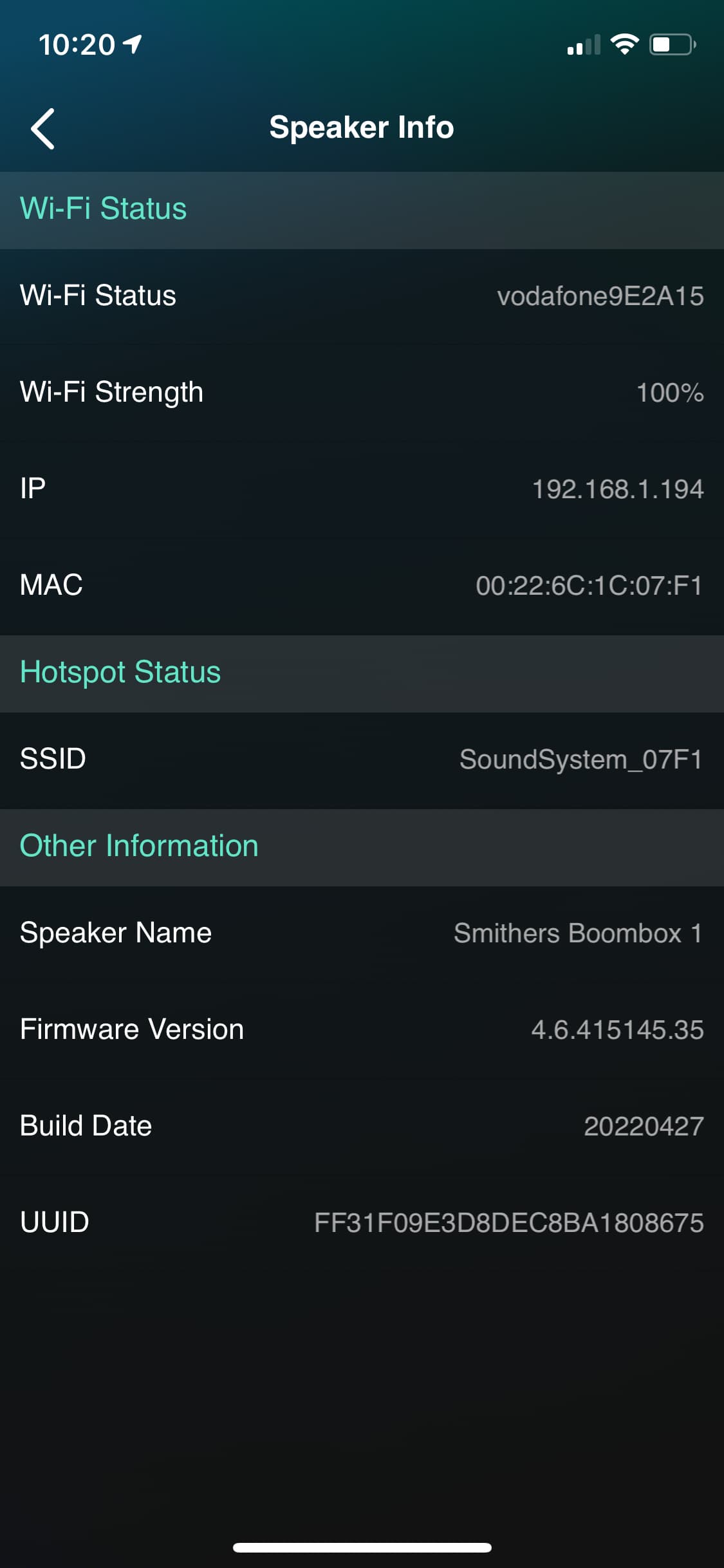

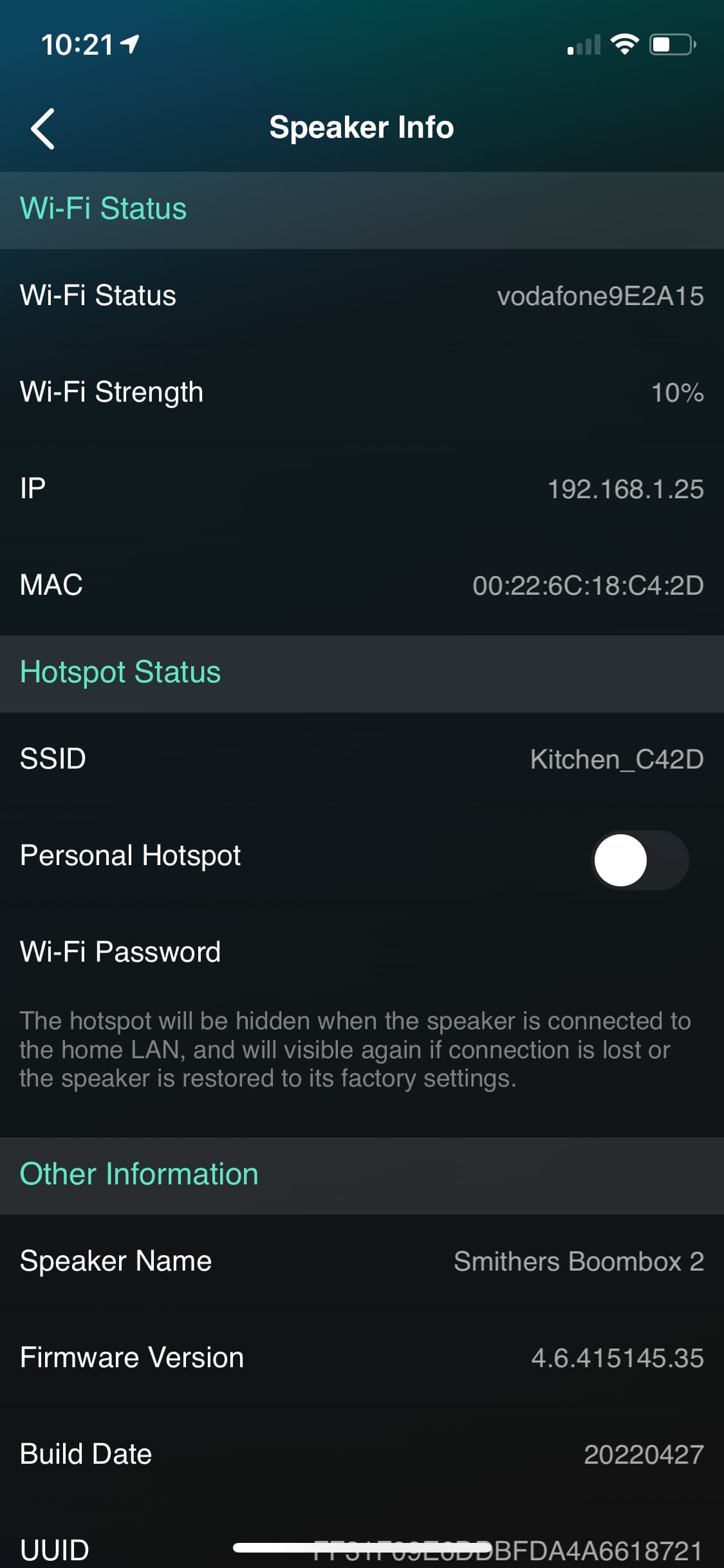

I have 2 up2steam 2.1 amps, both set up in the same position 5m from my WiFi router, 1 amp has 100% WiFi strength and the other has 10%?
Boom box 1 amp is installed in a box with WiFi aerial fitted, boom box 2 is sat on my bench with aerial also fitted, the signal is so weak it cuts out when I walk between the direct line of sight between the amp and my router.

I would advise to change positions of your 2.1 Amps. And then check the WiFi strength again on both. If the same Amp remains having the poor signal, something could be wrong with the Amp. If the good one, changed into the position of the bad one gets a low WiFi strength, then it is probably the spot having poor coverage and WiFi reception.
Both Amps have a direct line of sight to my router, moving them makes no difference.

I think that your last assumption is correct, probably a defective Linkplay board.
Just as a matter of interest, have you tried using it with an Ethernet cable? It might narrow down the problem being wifi only.
Morning Steve,
Ethernet works perfectly, I suspect the firmware update bricked the amp due not being able to complete the update over WiFi.
I’ll be honest, I didn’t even try plugging in the Ethernet before I shelved the amp last year, which is annoying as I would have spotted the defect sooner and resolved with the seller.
Looks like this amp is destined to be hardwired :-1:
Maybe its worth to try to do a Firmware refresh. And afterwards check if the WiFi works fine.
By the way, are you able to stream via Bluetooth?
I suspect the antenna, the FPC antenna is very fragile and easy to be damaged, could check if it’s still fine first. And then maybe check the connector, and coaxial cable.
