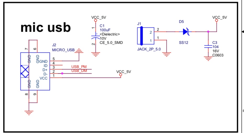

That’s really weird, none of my boards are powered from the USB mini connector and never had any issues.
The only difference between the two connectors is a barrier diode on the screw connector (to ensure correct polarity)
ok, I stripped the USB charger out of it’s case and attached it to the binding ports and it worked fine. I realised the USB charger was also supplying 2.5A so that clearly wasn’t the issue. There was obviously something weird about my 24v stepdown that it didn’t like. It was a bit disappointing that the Arylic support were talking such nonsense.
