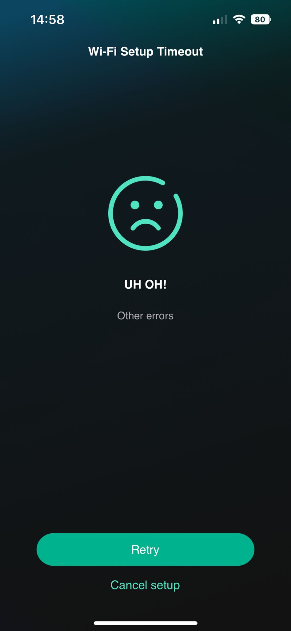

After working fine for a month or so, suddenly all three modules lost connection to the WiFi network, and are not able to reconnect anymore. This is what the 4Stream App shows:

- After 10 seconds the LED stops blinking and goes to solid. Though the 4Stream App continues to try to connect the Mini to the WiFi network. Then after a minute or so, the screen changes and shows ‘Wi-Fi Setup Timeout’ like in the screenshot above.
