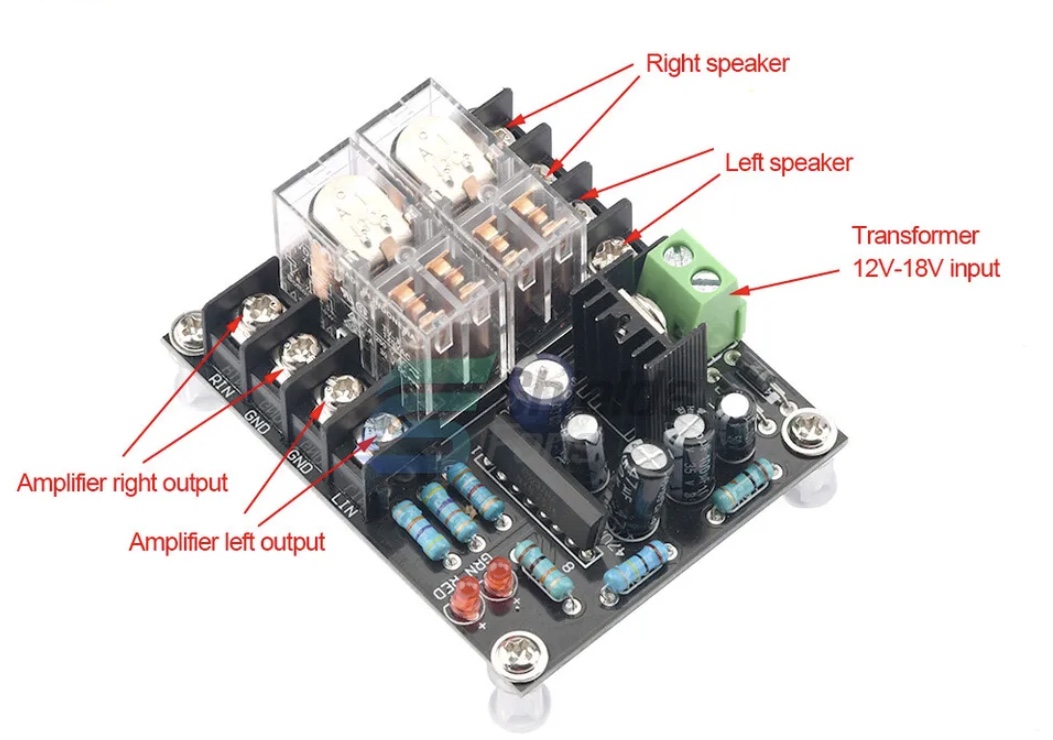

I’m using a bit more complicated setup and this would be an overkill for you, but I have an upc1237 based speaker protection circuit which can handle this as well.
