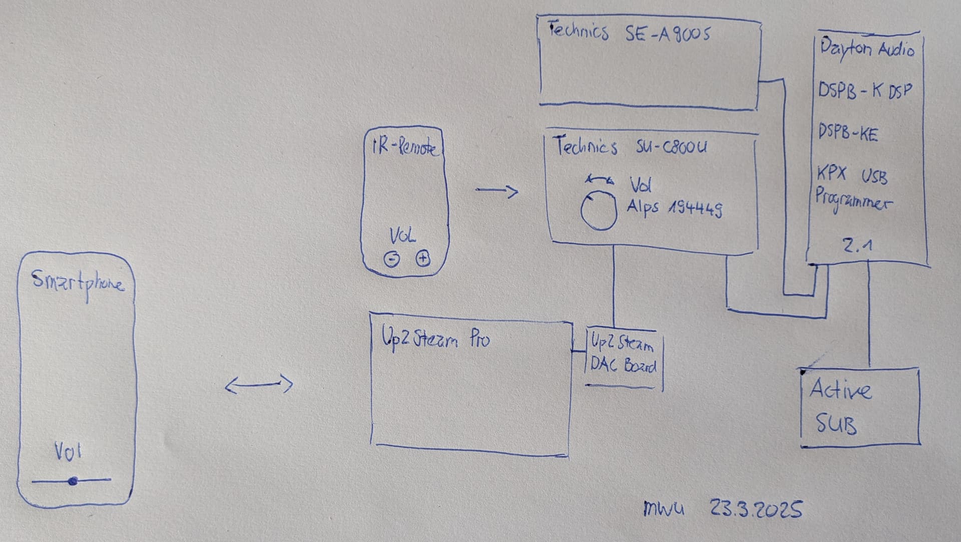

Attached is a schematic of my planned setup. I want to process the UART signal with an Arduino and adjust the potentiometer Alps 194449.
If I implement the pre-amplification with a Dayton Audio DSPB (I am also happy to suggest alternatives),
I can use one channel of the potentiometer for feedback back to the Arduino and use the second channel to set the volume on the DSP.
This way the system would even work bidirectionally.
I realise that this will not be a high-end solution. But I like the design of my old system.
Anyone who has got a taste for this and would like to convert their old amplifier.
An ALPS potentiometer with motor and IR interface costs less than $10.
I would be happy to make my Arduino code available.
