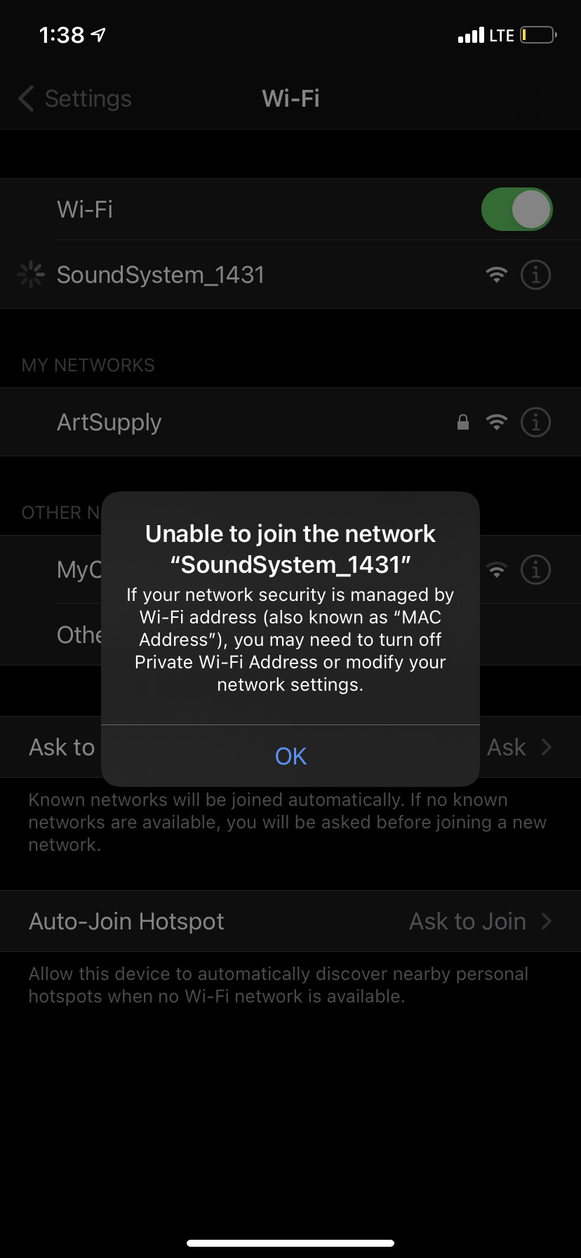

Anyone tried to do this? I have it set up with my home network but tried at my work and the light would flash but it would not recongnise the Up2Stream. The only time I had any “luck” was if I turned the Up2Stream Mini V3 on and had my wifi open. The network would show up and then I would get the following error. Any help would be appreciated :)))
@Will_Bodewes what’s the hardware ? Android Phone ? Router ?

Try to connect to amp own wifi (soundsystem…) network and then go trough app to add to your wifi
