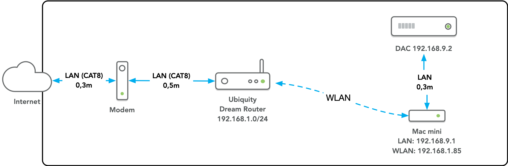

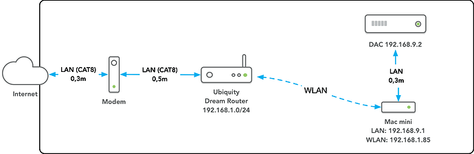

I wand to connect the Up2Stream HA DAC directly with my Mac - running Audirvana - to replace my current Streamer/DAC. Because of this I need to add a fixed IP-address. The goal is to eliminate any switch between the two devices.
How to configure this? Does the Up2Stream have a Web interface for this???

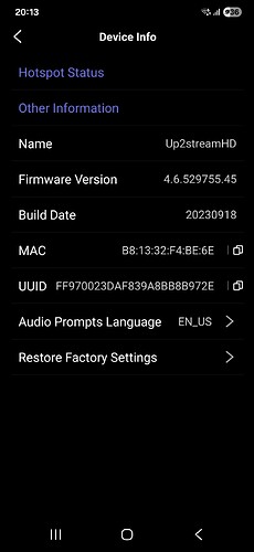

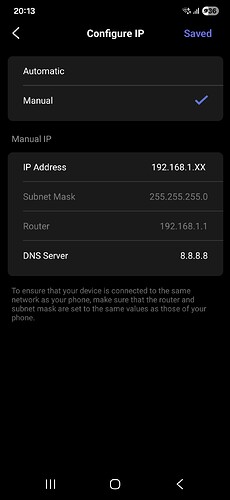

Use Wiim home app instead of 4Stream. It’s more flexible and allows to set IP manually. See printscreen
