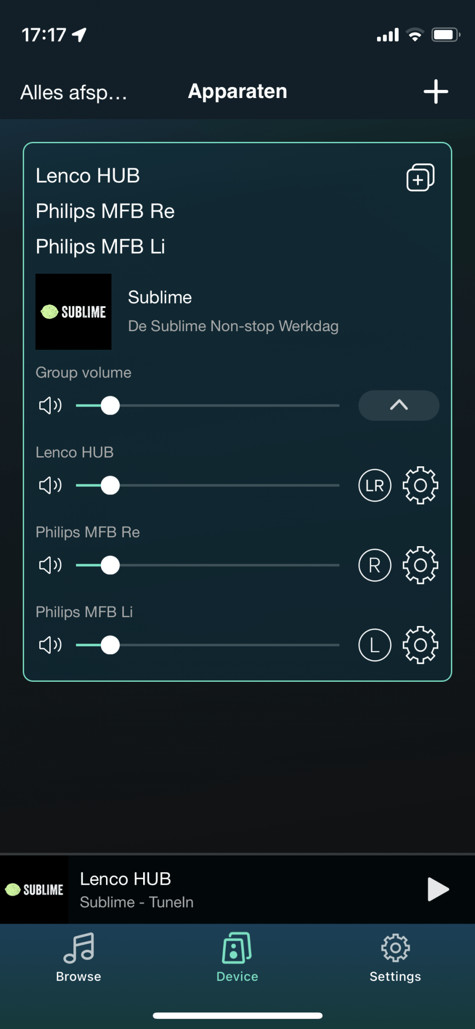

Configuration: The 4Stream App is used to configure the right setup of the S10 and the 2 MFB speakers. On the left screenshot you can see (from top to down) the Lnceo HUB which is the S10, the left MFB and the right MFB speaker. In the right screenshot, they have al been combined to one system. Note; its important to start with the S10/Lenco HUB, and add the two MFB speakers to the Lenco HUB. This way, the S10 will be the combining hub for all ways of playing music.

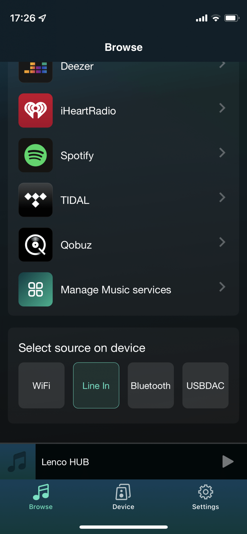

Streaming vinyl: Put a record on the Lenco turn table, and switch the music source in the 4Stream App, from ‘WiFi’ to ‘Line’ (see screenshot below). Or use the remote control that comes with the S10 and just push the LINE button on the remote.
