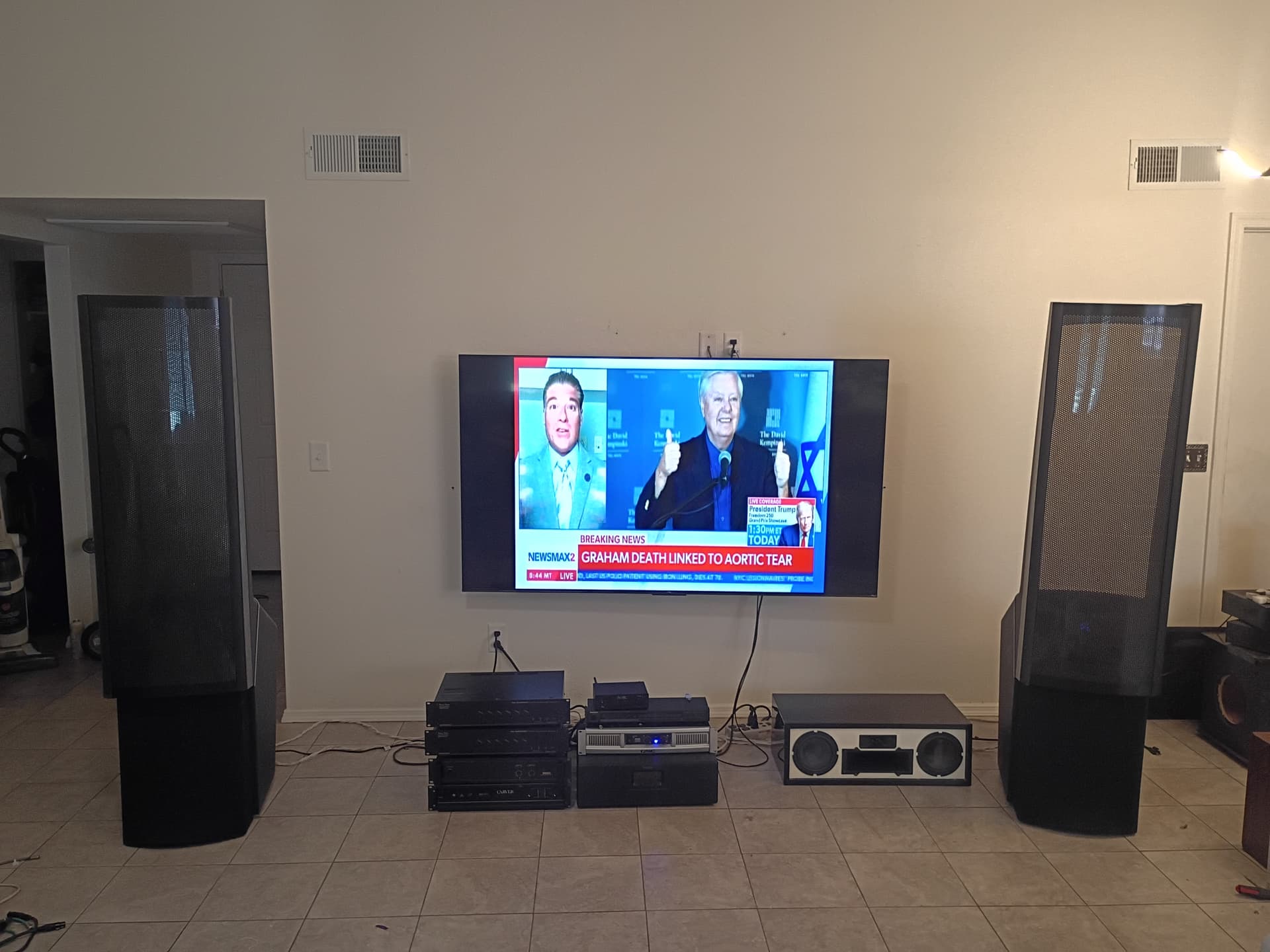

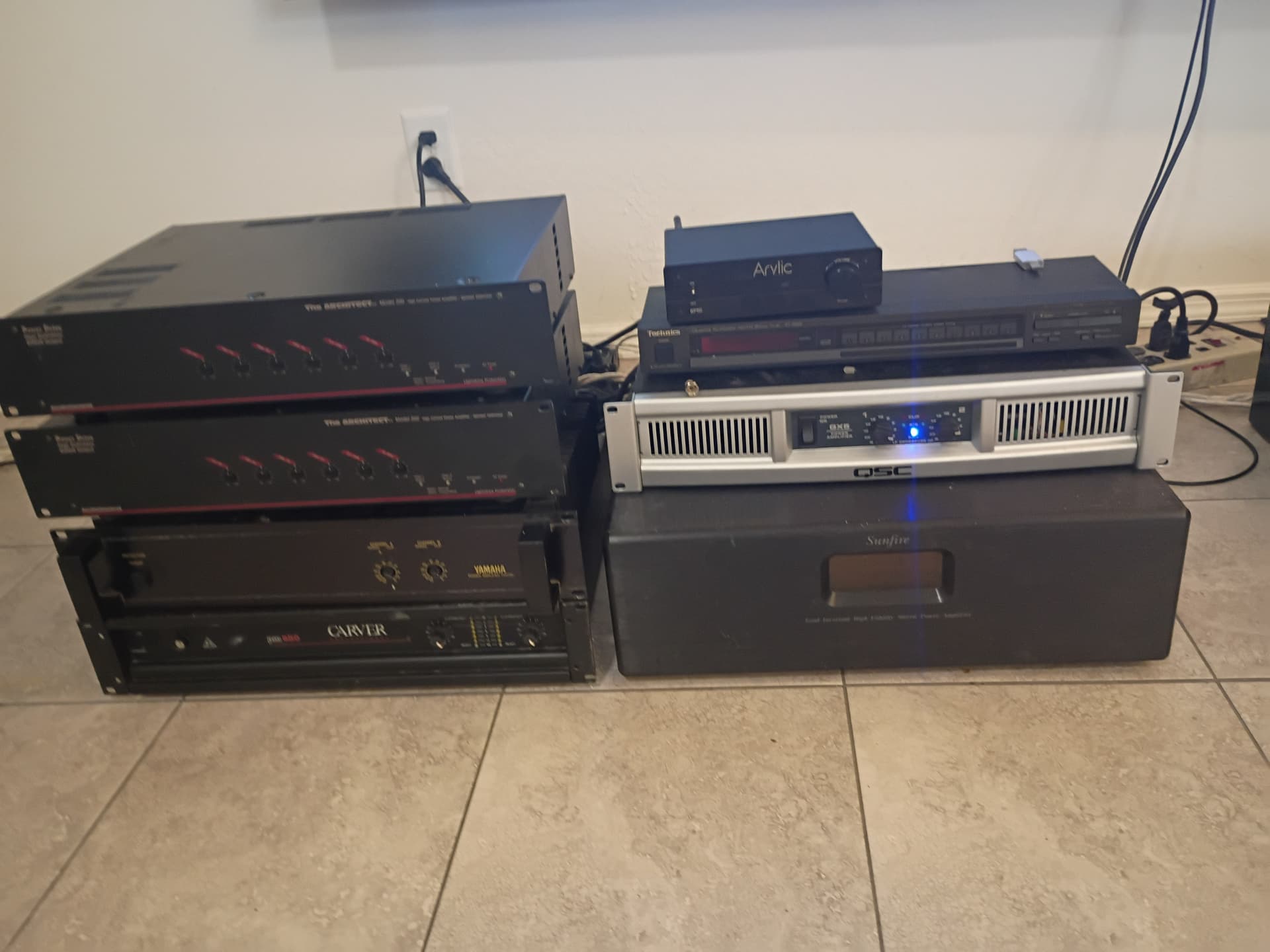

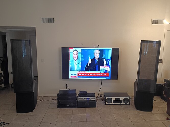

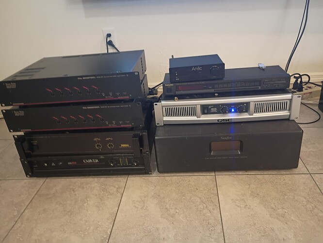

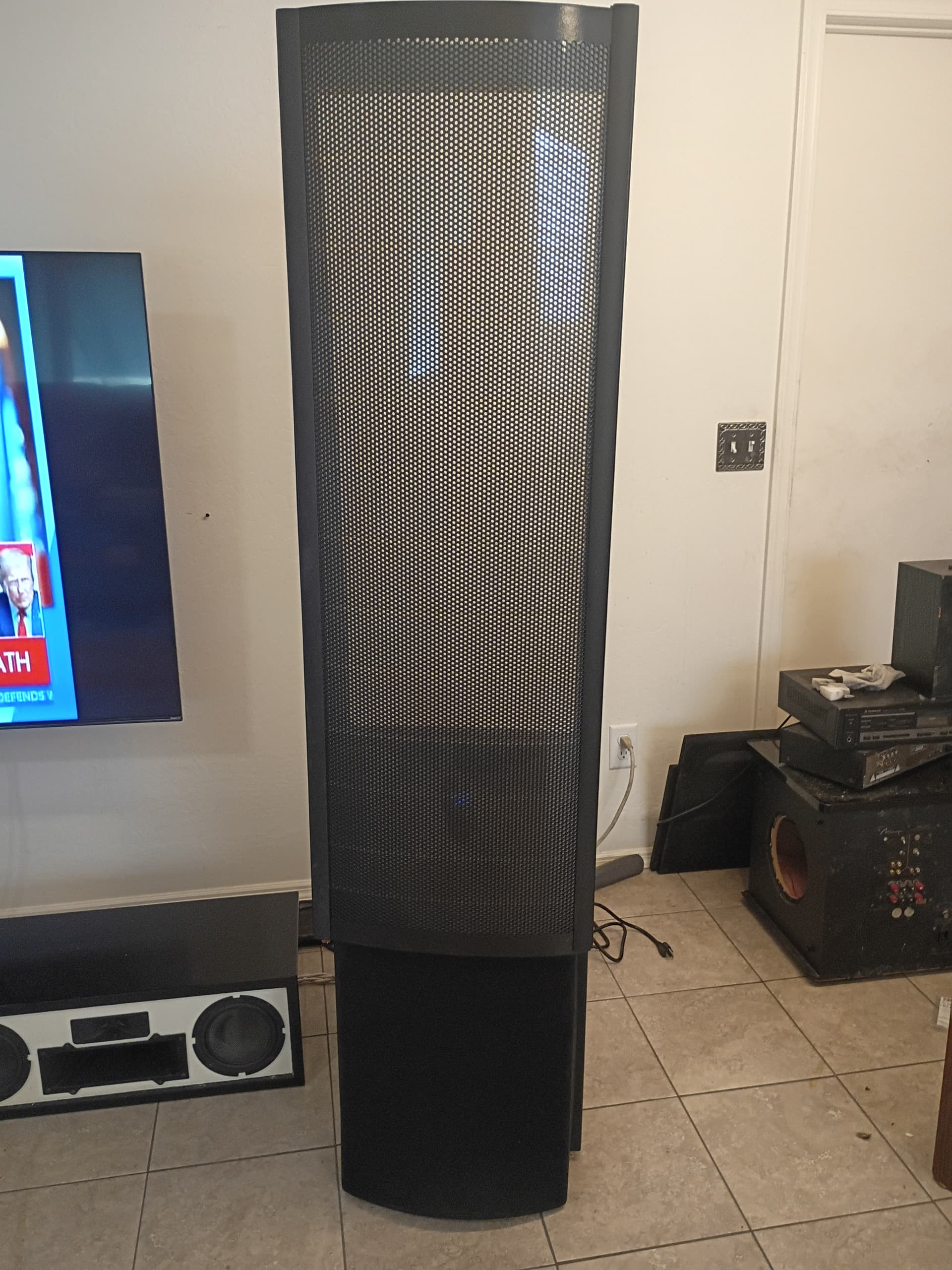

How much sound can you get from a B50m I have amps that are rated at 75w x2 and 150w mono and I barely get enough sound when they’re nearly maxed . I switched to 2 big Sunfire grand amps and I’m never running it higher than 50% and things are vibrating exposing different objects resonance points even at tv watching volumes. Dramatic difference in overall sound.
I couldn’t get far enough away to fit the entire set up on the frame. Right now the big black Sunfire powers the panels and the QSC powers the woofers I was running the Carver (right bottom amp) on the woofers but like the QSC better plus it has zero fan noise. I have other stacks of amps I’ve used but theres nothing like high power and high current to make speakers come to life.
Get some 700w x2 amps with over 300 damping and you’ll be amazed at the difference in overall sound. I use the BD50 as the pre and the crossover set at 250Hz. The Sunfire will put out 1200 watts per side at 2Ω the QSC is 725wpc @ 4Ω the smaller Carver puts out 475wpc @ 4Ω the 2 Audio Control put out 420w mono @ 4Ω each and the Yamaha is a tiny 45w x2 @ 8Ω.
I used to run 2x 40+ year old QSC amps that put out 1500w mono @ 4Ω but they finally died. I have 5 working BGW amps that are 50 years old that put out 75wpc x2 @ 8Ω and a few others that are 200wpc @ 4Ω. QSC amps are clean and have exceptional bass output, I’m picking up a QSC GXF8 today rated at 1200wpc x2 @ 4Ω for $450 or less (with DSP).
Theres no comparing the lesser watt amps, there’s just something missing even at low volumes the sound is way more full.
