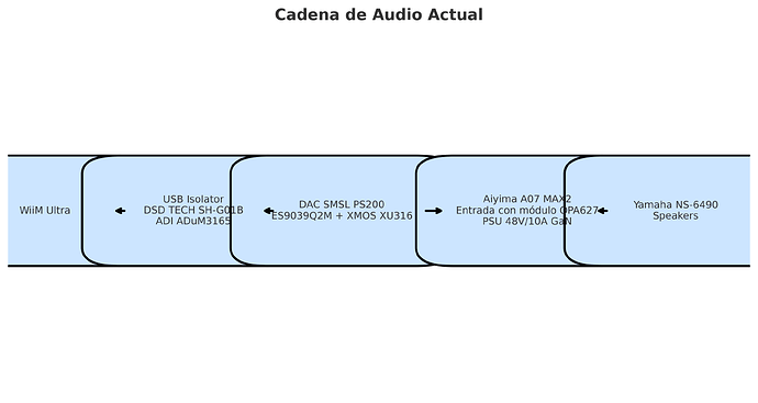

I am not in anger, not since I got my $329 Wiim Ultra, that have served me to build setup that works a sound like an audiophile system worth thousands of dollars for less than $500.
Here is a picture of what I use to listen to music (without flaws or isues).
I am pretty sure that you can NOT build something like that with an Arylic BP50 as the base.
Enjoy your so-called Price-wise solution and I will be delighted with my Worry-Free/Less than $500 Audiophile Setup.
I was thinking to sale my BP50 but I am Human enough to do not harm another human being with that burden.
Cheers!
