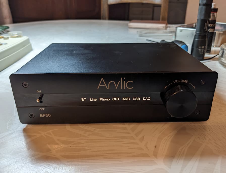

Because of disappearing LED-inscriptions for the active input on the front panel of my BP50 => Arylic had sent me a (new) replacement BP50 from the German Arylic warehouse, which was supposed to have a re-designed PCB design because of this defect, which several people seem to have. After a few weeks of activation (there seems to be no standby mode) that current LED-inscription for the active input has - again - dimmed considerably, I would say - roughly - by about 70% !
It looks to me, as if the current behavior of the BP50 display has not changed in any ways compared with the returned âoldâ unit, which I already had sent back to the address provided by the Arylic Service, because it behaves the same as before: after some time the input LED has dimmed considerably and will probably die completely, leaving then only a dark front display. Are You sure, that the display (front) PCB has really (?) been changed on that (new) replacement unit because of that identical behavior / defect ?

I had the already exchanged BP50 because of that same problem (see my former posts) switched on for some time now and the âLineâ LED, which was used as the default setting after âStdByâ in the meantime, is almost unreadable by now. Customer service of Arylic told me, that the problem had been solved by a redesign of the PCB some time ago (the reason for that mentioned exchange), but It looks to me, as if only a larger resistor was used for the display of those input LEDs: the brightness started somewhat less with the new version and has diminished afterwards to that mentioned state as listed above. It is âdarkâ by now, almost unreadable during day light, barely readable at night time. The corresponding LED will probably disappear completely in the near future, leaving only a blank screen for that input.

I have checked the LED âLineâ indicator again (several times) and it is now almost unreadable during day time, barely readable (very dim) during night time. Other inputs will probably show the same behavior. It doesnât look to me, as if there has been done anything to ensure a longer lifetime to those LED input descriptors.

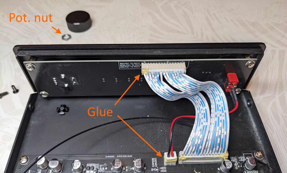

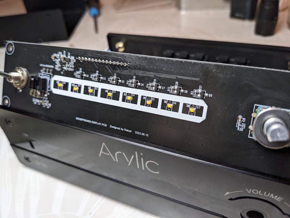

I juste replaced all LEDs by 0805 warm white model.

I found LEDs in a french ebay dealer (itm=140660899949)
I prefer warm white and they have the same tension max (3.8V).
CMS replacement requires dedicated tools and a good magnifeir glass.
The most complicated for me was to remove the old LED. A trick is to use two soldering irons (15W).
I only have one but a good side cutters. I cut the upper part and separated the rest with a flat and thin screwdriver.

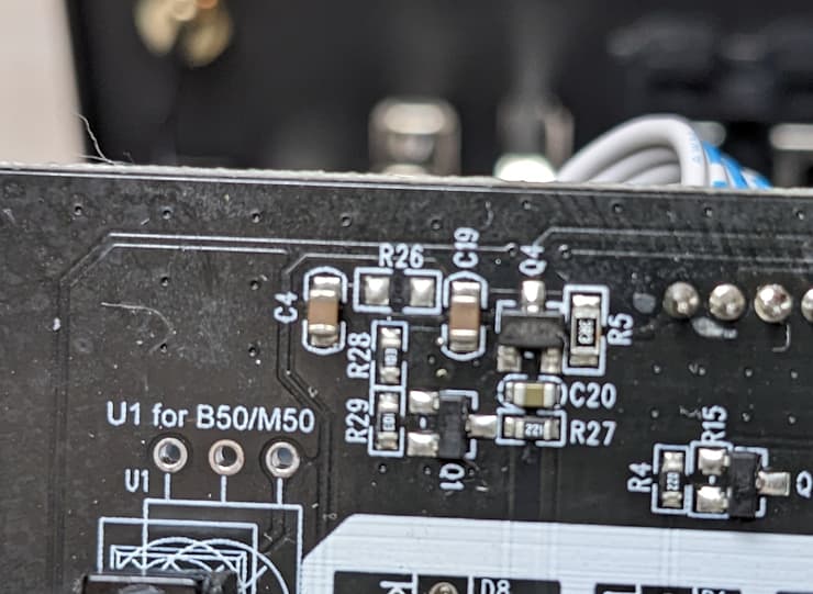

@Rene, I mesure 3.8V at each original LED, seems a bit much, no ?
Which resistor you changed for limiting the current ?
@Rene
Which resistor(s) had You replaced with your 10K resistor as stated ?

I just followed the relevant PCB track, removed the SMD series resistor, replaced it with the 10K resistor. 10K was found to be the best value to match the brightness with other LEDs. I did not photo it.
LEDs are current driven devices, so the voltage is not very important given the fact the current is limited by the resistor. The actual value of the resistor depends on the brightness you desire and the efficiency of the used LED. Values 1 - 10K are safe.
