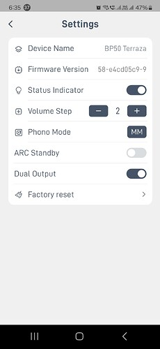

Check the settings in the APPControl and set the Volume Step to youre liking.
My B50 seems to ignore the step setting in app. I was on v60 firmware and TV remote changed volume by 3 each time. Now I’ve downgraded to V57 to resolve some issues, volume now changes by 6 each time.

I’ve been trying to find a solution for this same issue. Cec control steps the volume either 6 or 12 notches rather than what the setting in the Arylic app is configured to. The b50’s own remote follows the setting, cec increment seems agnostic. Both the Roku remote and the tv remote behave with the 6/12 step.
