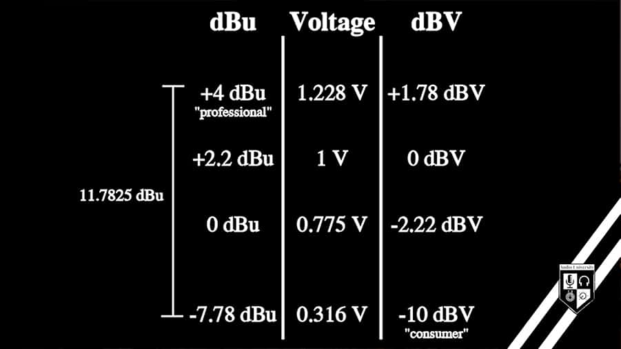

Yes. I got the answer to my question, thank you. But it is not clear why Arylic uses levels that are completely different from those used around the world?
Professional equipment uses 0dB = 0.775V, consumer equipment uses 0dB = 1V. This means that I will never get from the B50 declared output power. Sad.
