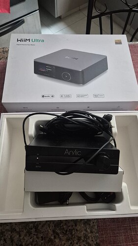

Look where the B50 is now!
Victor, you deserve the title of Arylic’s #1 disparaging cynic!
I accept the title, but you know why?
Because since the day that I spent my hard earned money on the piece of crap that you can see in the photo, I just have had hard times.
The Support Department of this Joke of Company it is inexistent.
I am happy lnow with my Wiim Ultra equipment but somehow I received an email from the forum and after months I decides to log back, just to see that my inquires and requests are STILL UNRESOLVED.
