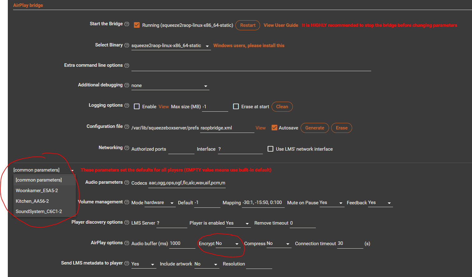

I have a S50 Pro+ and I’m having the same problem. The device is playing music, but no sound coming from it.
Setting Encrypt to ‘Yes’ doesn’t solve the problem.
Any ideas?
Are you doing this in the airplay plugin for the specific player?
You mean I have to set the Encrypt parameter to ‘yes’ on each individual device in this drop down list? I only have tried setting it to ‘yes’ in [common parameters].
Yes I set it for each individual device.
