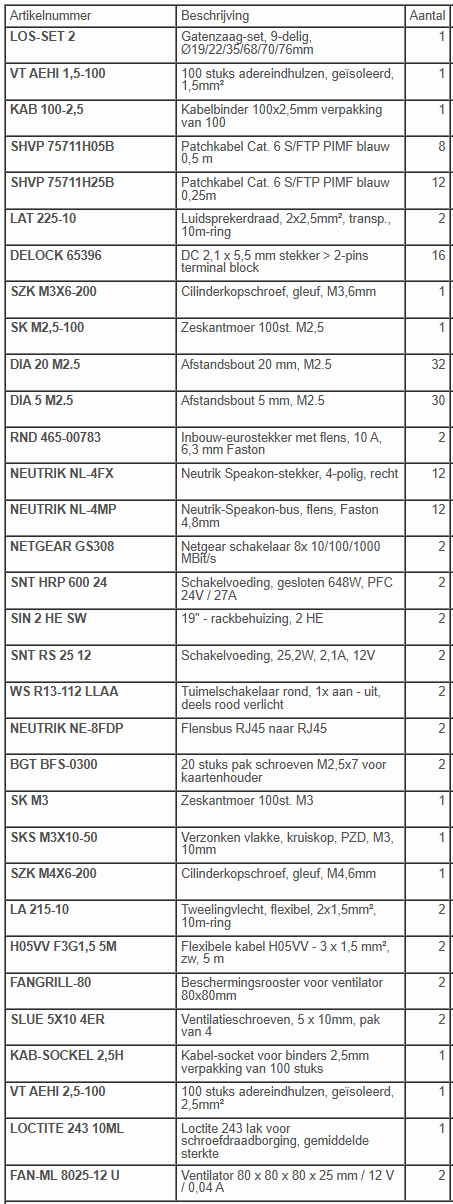

@LeonNights @DanO
Here is the parts list, I ordered it at Reichelt Elektronik.
