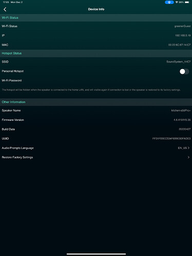

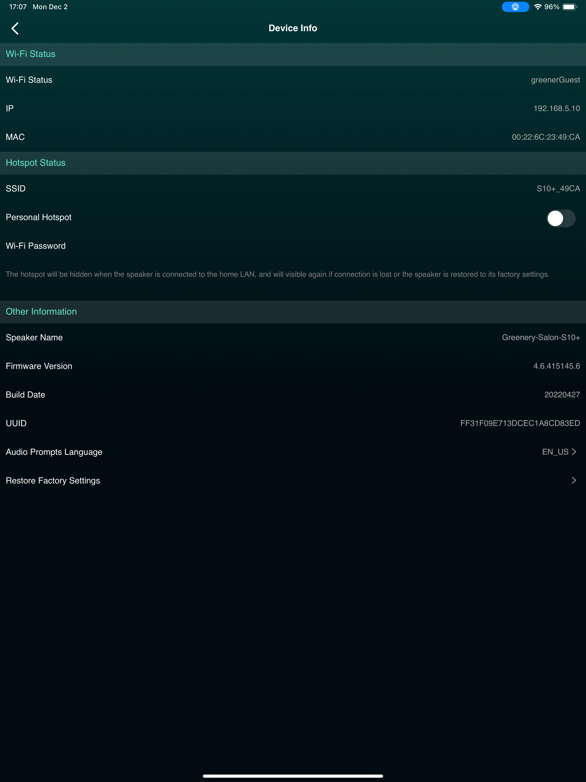

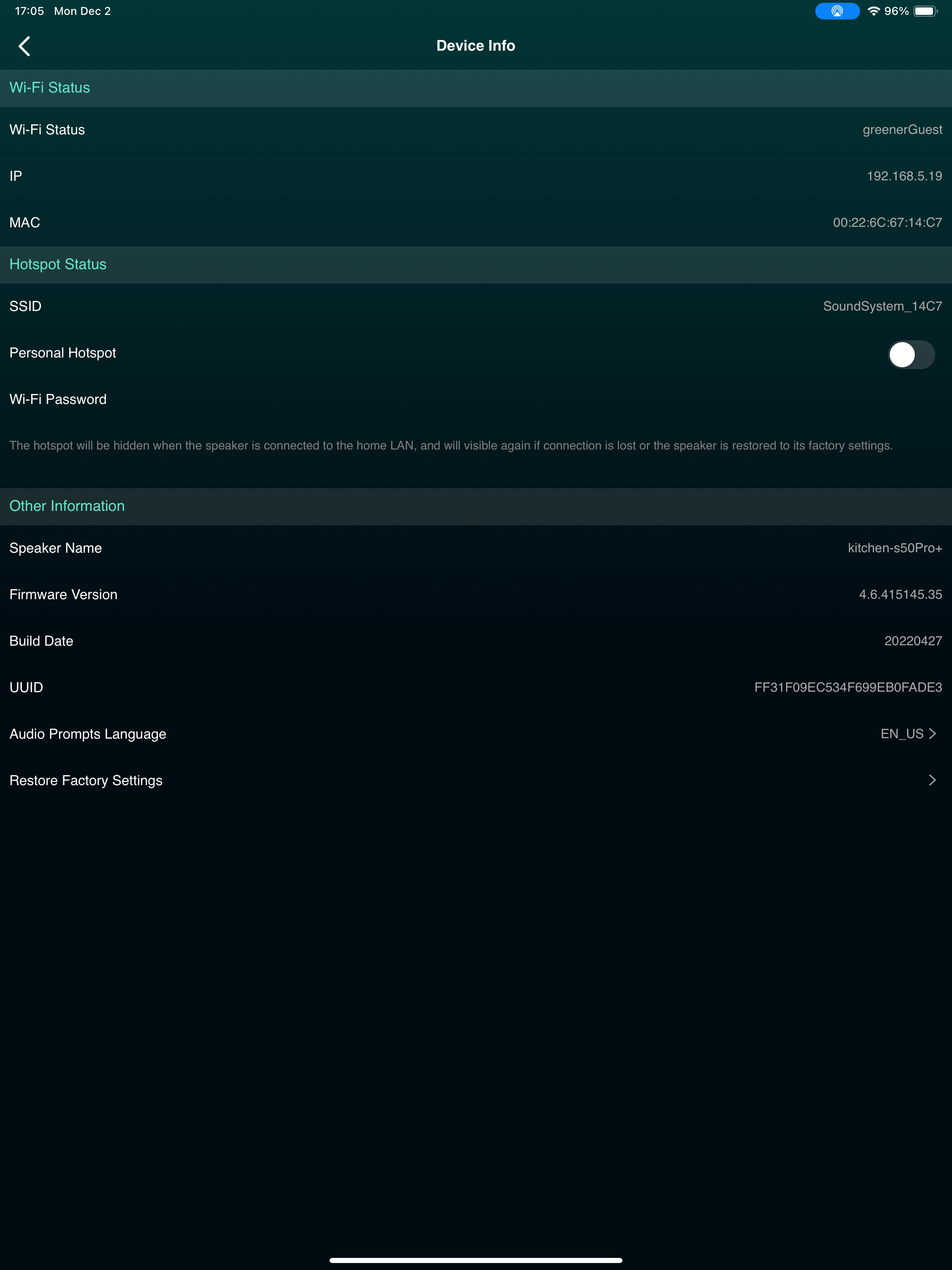

I am trying to do “multizone”.
When I click the link button, and select another streamer, it eventually says “fail”.
I don’t seem to be able to drag & drop from Apple 4Stream app.
Any help would be much appreciated.
